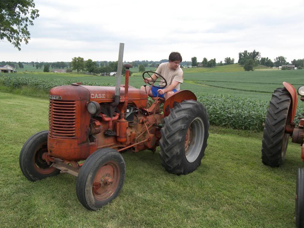

I inherited what appears to be a Case Model S from my grandpa. In remembrance of him I want to restore it to its original form. From what I have read there should be a serial number plate on the instrument panel. Well unfortunately there is not. So I was wondering if there is another place on it where the serial number could be. I just want to make sure that I have all the facts before diving into the project.

It does look like the engine from an SC has been installed into your tractor.
Are there any family records/paperwork or original owners manual that may have the serial number written in it?
I still believe you have a SO.
The oversize turf tires are common on orchard tractors used in sandy ground. The exhaust appears to have been modified in an upward position. There is no air stack.
Here's a pic of my S. Notice how much taller the steering shaft is. An SO has a shorter shaft like yours. Also your left hand light bracket is like an SO uses. It also looks like it has been moved higher than original. The tractor looks to have had a blade on the front and the lights were mounted higher to be above the blade.Your right hand light bracket looks home made. Most SO's only come with one front light.
The parts book shows your throttle was used on SO's from serial # 4600001 to 5313815.

Case made SC 's with a wide adjustable front and the last ones you could get with a sold front axle also the "S"/"SI" and "SO" tractors all had a solid front axle with 24" rears all SC's had 38" rears here are some of mine first is a "S" next a "SI" and last is a "SC" with adjustable front
