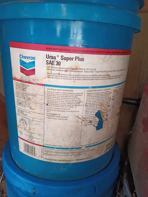

Quoting Removed, click Modern View to see Probably ALL. Engineers designed those engines to generally wear out everywhere at the same time. This would be different if the engine was overheated or had a bad air cleaner hose and was dusted. I said 30 wt NON-Detergent. I'll bet you have detergent oil which usually smokes more.

grandpa Love
11-19-2023 13:23:25
Report to Moderator
 Re: Allis IB smoking in reply to DrAllis, 11-18-2023 15:47:38
Third Party Image
[Log in to Reply]  [No Email]
grandpa Love
11-18-2023 16:26:31
Report to Moderator
I will check.

Honestly, I'm sure it's both and too wide of grooves in the pistons and a ring edge on all the sleeves. Do yourself a favor and try some of the cheapest straight 30 weight NON-detergent oil and give it the same run time and see what that does for the smoke factor.

grandpa Love
11-18-2023 14:54:05
Report to Moderator
 Re: Allis IB smoking in reply to DrAllis, 11-18-2023 14:15:01
I'm running straight 30 weight..... Longer I run it the more it smokes, usually they smoke a while and clear up , after they have sat for years.... Darn it.
