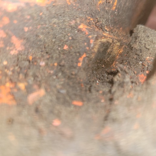

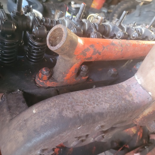

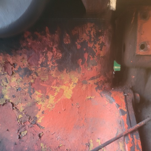

I can't find where the engine serial number is stamped. It must be a late model tractor since it has a slightly curved shifter and has the snap coupler hitch but I realized yesterday the water manifold must be from a early WC? So I plan on putting one on with the 3 bolt thermostat. Third Party Image

Could that be a Leroi engine?

Yes. Older WC/WF engines are on the rear of the block at 12 oclock where it meets the bellhousing. Anything else is directly behind the carburetor air cleaner hose, which doesn't seem to be there. If a block was ever replaced with a new block (because someone let the original block freeze and break) a new block will NOT have a serial number !! unless the repairman had stamps to do so, which is doubtful. I have no idea what's going on with your rocker arms, but in 55 years I've never seen roller tipped rocker arms on an AC engine !!!

I got the tractor like that not running and when I put the head back on I had to put a washer under each of the 4 mounts in order to get clearance, so I don't know what the roller rocker is from.

On WC its on back of block rite above where bell hsg bolts to block. Below fuel tank support. Think seen on D17 a boss on side of block in front carb that had numbers stamped.

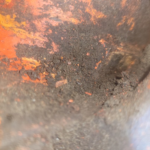

jhncp
11-17-2023 12:10:07
Report to Moderator
 Re: WD engine serial number location in reply to shaun wallace, 11-17-2023 09:57:37
I see W O stamped on the back of block so it must be from a WC
