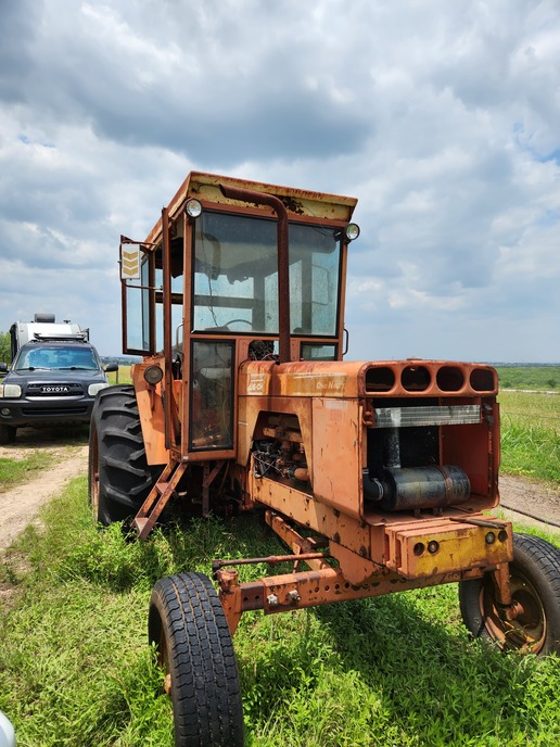

I just acquired and early 190XT gas tractor and it has a 3pt conversion that mounts to the snap coupler drawbar. I also have the opportunity to purchase a later 190 diesel parts tractor that has the Allis factory 3pt on the back. Will the newer 3pt /drawbar mount properly on my early 190? It looks like the drawbar support on the early snap couplers are a bit different (since its removable) than the later models.

Transfer over everything. It all will fit. Tractor was available with either style of hitch when it was brand new.
