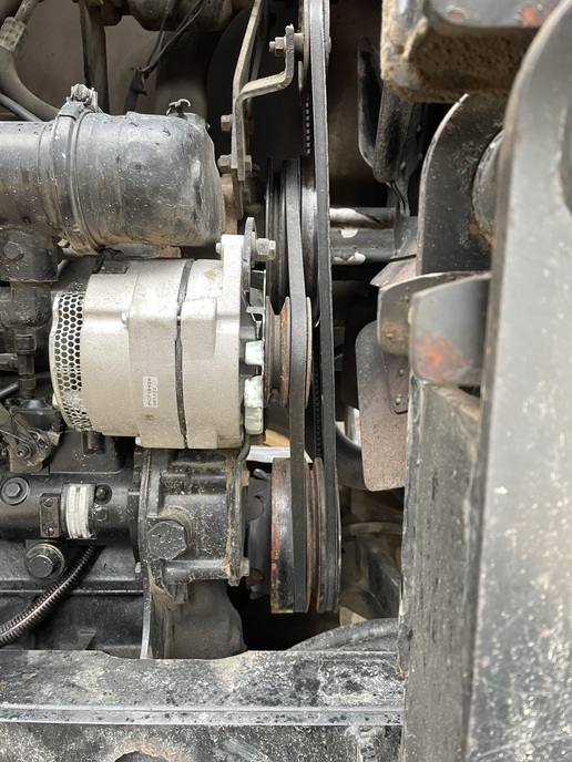

On my recently purchased, 8010, the crankshaft harmonic balancer with a 3 v pully grooves does-not line up with the alternator or the fan pullies. Even the air conditioning is out of line a little. So, I am assuming someone did this in an engine repair but just left it out of alignment and quit. So now, how do I repair this alignment or new parts?

If the belt grooves are out of alignment, it is because the vibration damper rubber has failed. Most of the time the grooves move towards the engine and will eventually rub a hole in the timing cover, so get it FIXED now !! The "fix" is replacement with a new one from AGCO. If the part is unavailable or too high priced, I have used this business in Salem, Oregon who rebuilds them to like new condition with new rubber. He is semi-retired and is CLOSED March- June- Sept and December. Price did run about $350 including 2-way out/back USPS freight. email: langsatherdavid@gmail.com He did one for me a year ago right now just before December shut down.

I'm attaching a belt alignment photo. The harmonic balancer is too far forward in this case. I can only use one belt with skipping a v groove over, so it does not run off the v grooves with double belts. Third Party Image

 Re: Allis Chalmer 8010 harmonic balancer in reply to DrAllis, 11-06-2023 18:04:11
Oh, Okay, that makes sense. It looks like it was put on backward.
