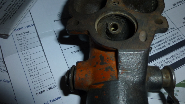

I've had this zenith carb sitting on my shelf for sometime now. Normally the carbs I see on the B/C's Allis's have a nozzle that sticks above the pictured hole in the carb. This bottom half looks to have a recessed (tiny) nozzle inserted down in. Were both types used during the life cycle the Allis B and C's?
Thanks for any insight on this question. I also have another that doesn't have any jet/nozzle in this location.

Zenith used several types of carburetors based on different castings. Mike's Carburetor has some diagrams on the website to identify them and should have parts.

[quote="CVPost-Dave Westlund"]
The nozzle has gone MISSING.
I'm not sure, offhand, if there's part of the nozzle broken off/remaining down in the hole, or if that's a separate small jet beneath it.

Wornout, It could be that the nozzle has broken. With that said I don't see threads at the top of the hole. Do you happen to know what thread pitch is used on the nozzle?

Trying to load a picture.
Third Party Image
