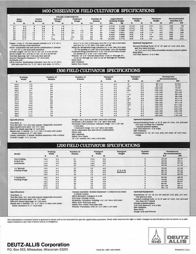

what are the differences between a 1200 series FC and the 1300 series FC?

Third Party Image
Heres a table of the models and options.

 Re: AC field cultivators 1200 vs 1300 in reply to Skyhighballoon(MO), 05-11-2023 08:18:37
will you email that image to me? can't get it big enough to read without distortion. thanks

DrAllis
05-09-2023 15:58:16
Report to Moderator
 Re: AC field cultivators 1200 vs 1300 in reply to farmerjack, 05-09-2023 10:37:19
Quoting Removed, click Modern View to see They made those units for a long time, so there are differences to each model as time went on. Basically, the 1200 is a THREE bar frame and the 1300 is a FOUR bar frame. Four bars being more strung out front to back to handle trash better than three bars. Both use the same shank and have six inch shank spacing. 1200's only went out to 21 ft width, while 1300's were closer to 30 feet. I'd say a 1300 weighs at least 50% more than a 1200 ft per ft.
