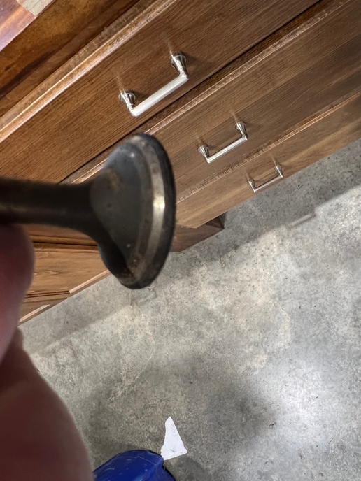

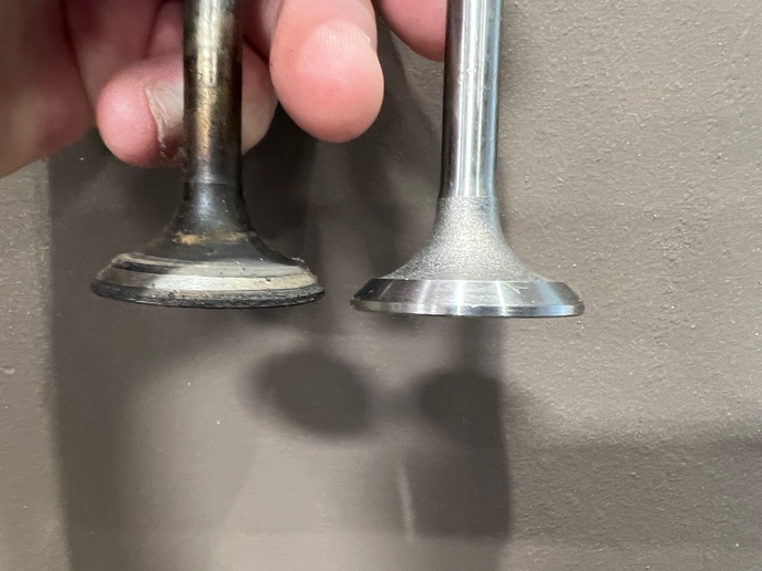

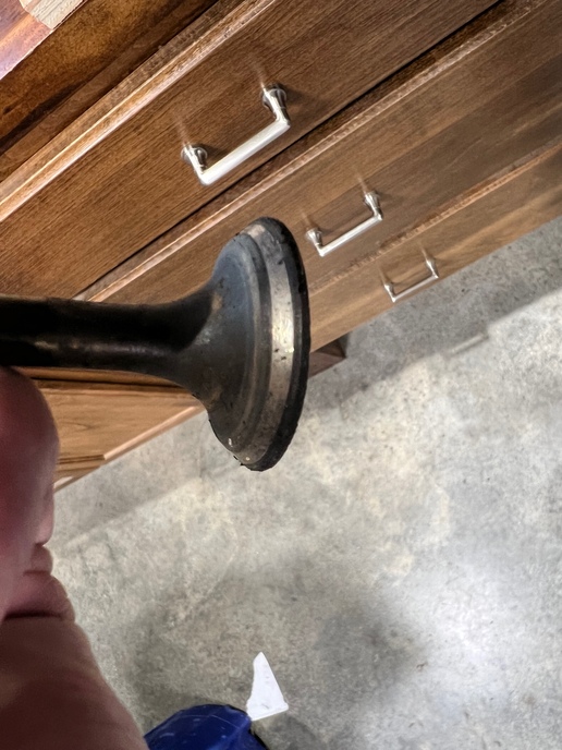

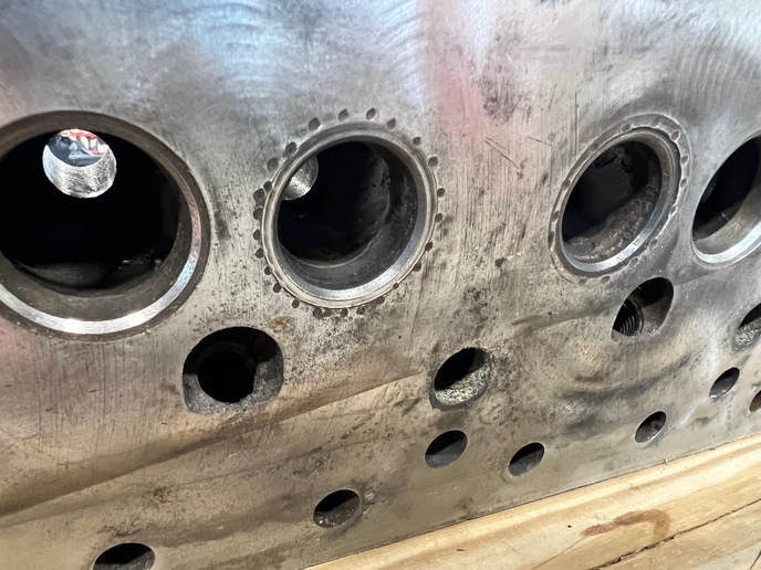

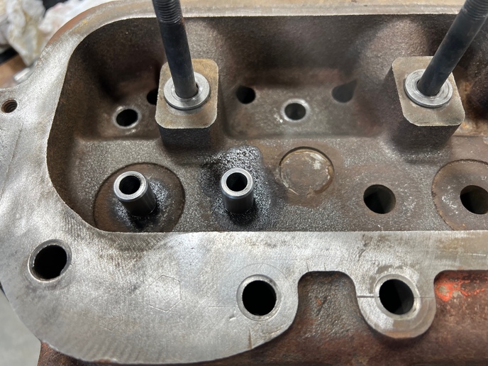

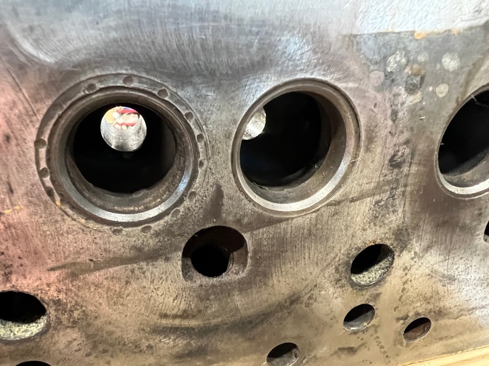

Took a couple of pics of this first valve adventure. The seats, after a good cleaning dip, look ok (to my untrained eye). One shot of two installed valve guides reveals some of the confusion . See the recessed port on the left side (think that is the exhaust valve in the pic). Other thing that is sorta interesting is the last two pics below of one of the old valves. The contact point on one side of the valve is much wider than the contact point on the other side of the valve. Suppose that's the way it has worn. So, with that, i'm probably going to proceed with a lapping procedure to see if i can get this thing to run. I'll save a pro total head/valve job for the complete overhaul which i suppose will happen sooner than later.
