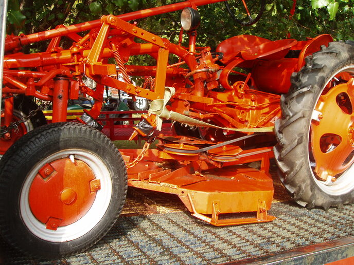

mdm1
05-07-2023 03:08:28
Report to Moderator
 Re: Any way to disengage woods mower on Allis G? in reply to mdm1, 05-06-2023 16:21:32
Thanks Joe. Looking at your pics mine is like the second one. The blades were on upside down. I will email you a pic of mine as I don't know how to post pics here.

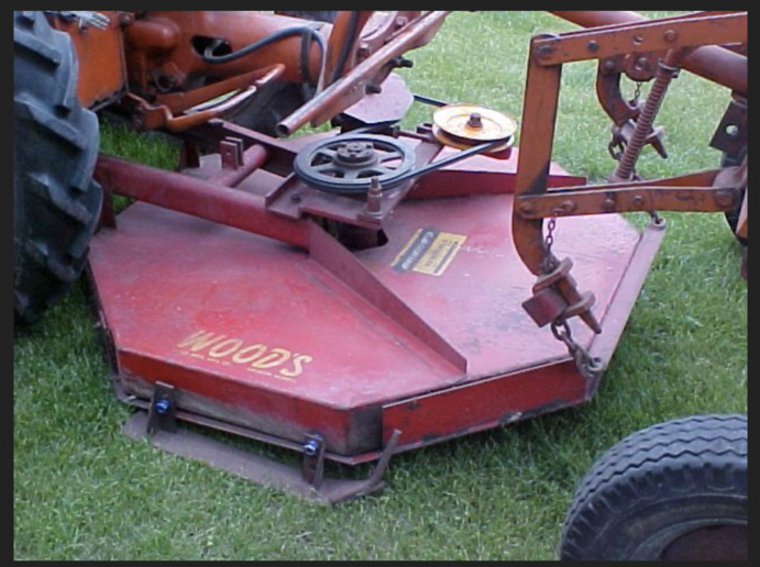

JoeM(GA)
05-06-2023 18:03:28
Report to Moderator
Derailing the belt is the only way to turn it off as for belt routing, this is the best picture I could find out of thousands I have. Usually the belt is off when you see one parked

JoeM(GA)
05-06-2023 18:09:45
Report to Moderator
 Re: Any way to disengage woods mower on Allis G? in reply to JoeM(GA), 05-06-2023 18:03:28
Third Party Image
