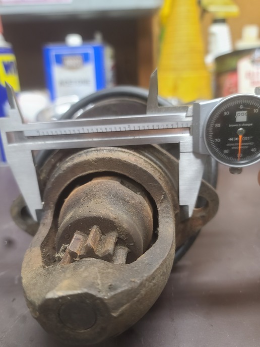

MHPull44
05-06-2023 11:50:10
Report to Moderator
 Re: ISO a 226 starter in reply to jaoneill, 05-06-2023 11:08:29
I measured 4-1/8 center of hole to center of hole, directly across using gage pins and dial calipers. The other snag is while looking at this, it appears to only have 9 teeth. I should've marked and counted them a second time yesterday.

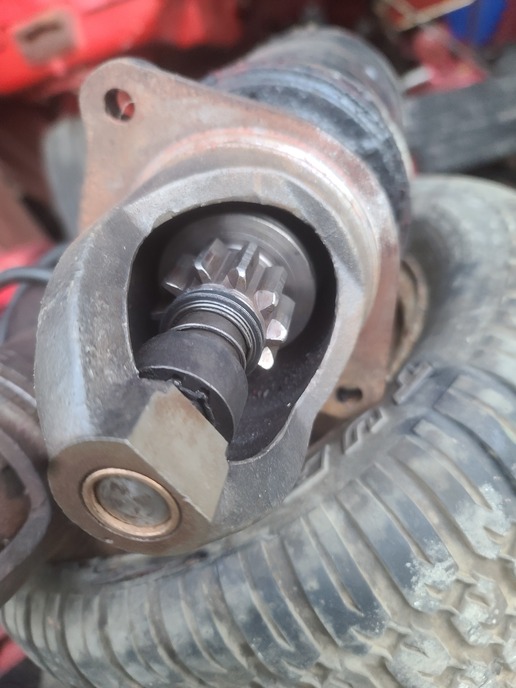

I'm thinking that the 2 hole should work. Would you please check the length of the nose? Face of flange to furthest edge of the gear; and also the diameter of the "shoulder" at the flange.
I'm curious, I don't believe I've ever seen a drive with the gear in the "engage" location when at rest. How does that work?

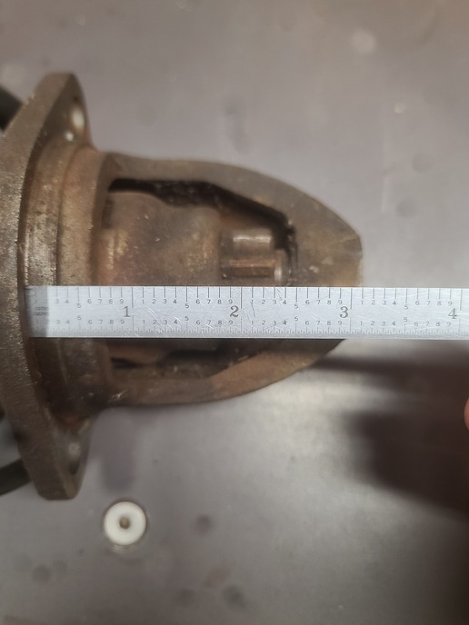

MHPull44
05-06-2023 10:46:33
Report to Moderator
 Re: ISO a 226 starter in reply to jaoneill, 05-06-2023 04:05:09
3.250 flange pilot diameter and roughly 2-3/8 flange face to gear

Some starter drive gears have a clutching mechanism which locks in the engaged position when the starter is energized. They don't retract until the engine fires and kicks the gear back.

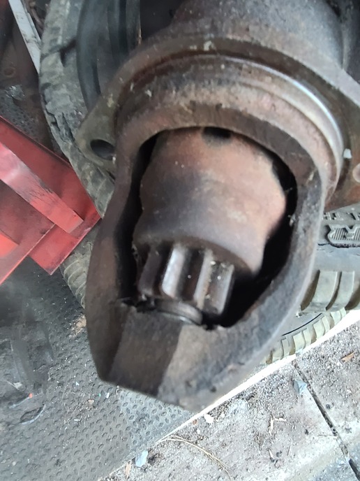

Which one is the 2 hole?
I don't believe that the first one (the one with the new looking gear) would work. The one that I took off is +/- 4" from the face of the flange to the outside tip of the drive housing and the flywheel ring gear is right at the interior of the nose (the drive gear would need to be close to the nose bushing).
The other one shows the drive gear where it would be in the "engaged" position on mine. This post was edited by jaoneill on 05/05/2023 at 07:13 pm.

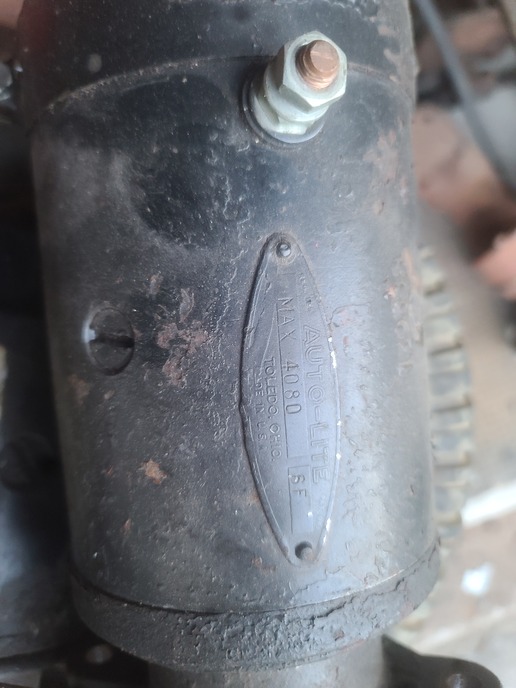

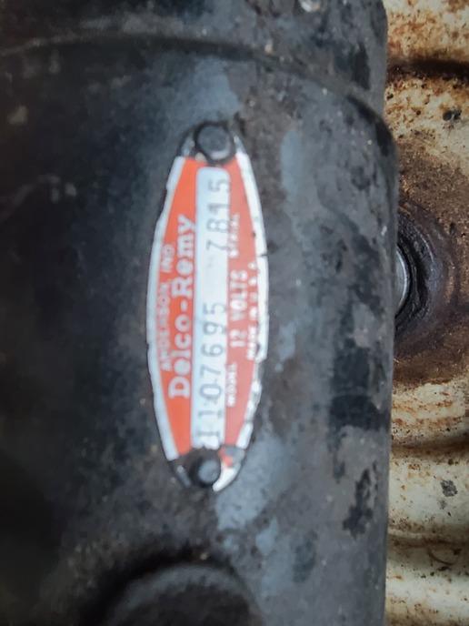

Quote: CVPost-MHPull44 (quoted from post at 21:15:00 05/05/23) Found 2 starters, one autolite MAX 4080
6F 3 bolt and a Delco Remy 1107695 7B15
two hole.
Would you know if they are both compatible with the G226 (D-17)?

Two bolt has the gear out towards end of the nose cone

The two bolt one was actually mounted on a Gleaner E3 combine with a D-17 style Z code engine. The 3 bolt one I'm not sure what it's out of.

Found 2 starters, one autolite MAX 4080 6F 3 bolt and a Delco Remy 1107695 7B15 two hole.

Autolite #MCL 6009A.
