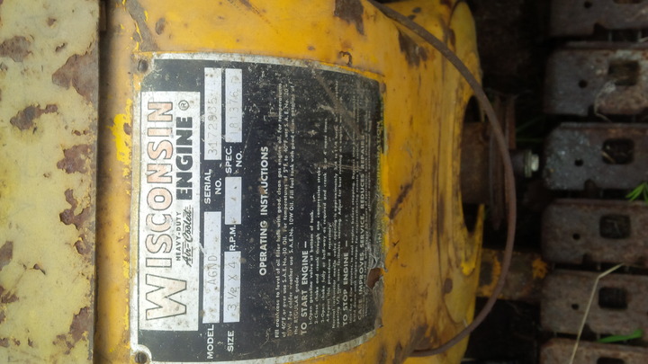

hey forum. hope everyone is well, this is a stretch but i am trying for the life of me to find a replacement starter for and old davis trencher with a wisconsin motor in it. i will provide pics. of motor badge and the starter. (it is the one on the right i am trying to source) the badge on the starter was basic only three letters, it is an old Nasco starter.

Here's 3 choices from the Wilson e-Cat.
You can GOOGLE the numbers to see what they look like and cross them to other suppliers' numbers.

If you check with Pitt Auto, make sure you give them the spec number from the engine nameplate to make sure it is compatible.

Current starter should be YA39.

thanks for the reply and help. should have noted i have a manual so part number not the problem the obsolete part is the problem. and i believe this trencher started as a generator starter option than configured to electric starter i believe the 27A/B number (whatever the smaller is. 3.5" or 3" i believe) i can find the one obsolete (the bigger one in the pic) but because this motor had generator option the head/block is different and doesnt support this bracket and starter. only the block that had the original starter has the machining for the interchange for 3" starter to 4" starter. i guess obsolete means good luck lol
