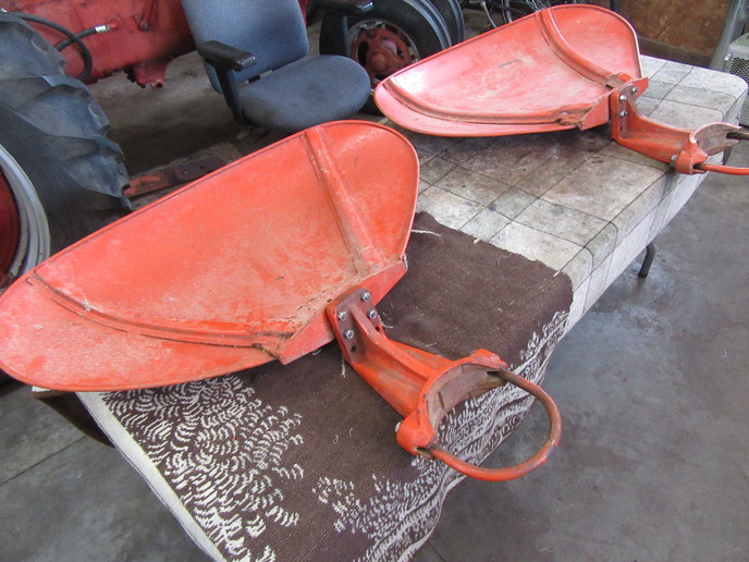

I attained these fenders in a package deal where I was told they would fit a Farmall M. Well, they don?t and I would almost destroy the fender mount for them to fit. Does anyone know what these fenders actually fit? I really just want to find a proper home for them.
They are in pretty good shape and are salvageable. See photos.

Case clam-shell fenders for newer S or D series. The brackets clamp around the axels. There is a "notch" at the top of the axel that prevent them from turning on it. jal-SD
Mid series SC Case tractors, possibly DC also? They are not the early style for 1941 SC Case tractors, and not the last style made for the 1951?-1954 SC Case tractors. They are the same style my 1945 SC has.
