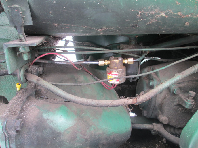

I went with an electric shutoff on three of my gas tractors. I hooked them to the coil so as soon as I turn on the switch,they open up and let the gas flow. Shut them off and the gas stops. Works great.
Amazon. Just search it on there. I think the one in the picture is actually from a nitrous kit,but I got the other two off Amazon. An auto parts store should have a whole catalog full of them too.
