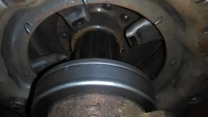

D15 Clutch Pressure Plate Fingers Out-of-Adjustment
wxford
New User
Having a problem adjusting the fingers on the clutch pressure plate after replacing the clutch. I noticed that fingers were nearly out-of-sdjustment when I replaced the old slipping clutch. I followed the shop manual specs for setting the fingers, but they cannot be set to make contact with the release bearing (bearing has about 1 inch of travel). About ready to just replace the pressure plate as I do not know its history, but hate to spend the $$ if I am barking up the wrong tree. This tractor has a lot of issues from previous owner(s) cobbling it up. Any thoughts on how to attack this problem - things I may have overlooked?

The clearance between the throwout bearing and the release levers is adjusted with the clutch pedal link rod, not the pressure plate fingers. To me adjust release levers evenly means small adjustments, if needed, so the throwout bearing contacts them squarely and at the same time. Major adjustment of the release levers would be when the pressure plate is assembled and I don't find any specs for that dimension or method to check it.
I reset the fingers on an E4 clutch by clamping it down on a table saw with spacers under it and depth-miked the fingers and checked with an indicator. I called a clutch and driveline shop and they gave me the specs. Still had trouble with the release once it was back in the tractor. I spent a few hours resetting them with a dial indicator till they worked right. Had to set one at a time and work my way around a few times.
#1. The clutch pedal rod positions the clutch pedal height. It doesn't control the maximum forward stroke of the throwout bearing. There is a stop inside the bellhousing that the clutch release fork comes up against. #2. The flywheel should have been machined perfectly FLAT and this includes where the pressure plate O.D. is located. #3. You should be able to easily adjust the finger to throwout bearing clearance once the tractor is rolled back together. If the fingers are too far away from the throwout brg (and the flywheel is flat) your clutch disc pads (4 pads) must be too thick, which will pull the fingers away from the throwout brg.

I would agree with that up to one point.....The maximum forward travel of the throw out bearing is FIXED because there is a stop inside the bellhousing. All the adjustment in the world of the link rod cannot change that. The complaint is the gap between the fingers and the throw out bearing is way too great and the link rod adjustment isn't going to fix that. The fingers must be moved closer to the throw out bearing.
Jim, DrAllis is correct in his assessment of my problem. I cannot explain why the old clutch-pressure plate combo kinda sorta worked, and the new clutch in the old pressure plate is not even close. The thickness of the old and new clutches are about the same ~0.024 inch. The flywheel doesn't appear to be turned down, and the pressure plate has been machined flat which should have compensated for any increased thickness in the new clutch.
The parts book show two pressure plate assemblies: original and service. I do not know which is in this D15, or how they differ. I believe the adjustment bolts are the originals (I thought about putting longer ones in as a test).

Well, here is the update at the moment.
New pressure plate arrived. When I set it up to the flywheel, I got a surprise - WTF!? The ring gear kept the pressure plate from coming in contact with the flywheel!? The ring gear stands above the flywheel by quite a bit - at least the thickness of the pressure plate housing. Upon inspection of the old pressure plate, I observed that the edge had been ground down to fit. I thought that the ring gear hadn't been properly seated, and ordered a new ring gear because some of the teeth were damaged (hasn't arrived). However, when I removed the old ring gear, I discovered that it was indeed seated. It appears that the inside diameter of the ring gear is greater than the outside diameter of the pressure plate cover. This implies that the surface of the flywheel and the edge of the ring gear should be at the same height (it's not even close), and the pressure plate will overlap the ring gear and kinda hold it in place.
I don't understand this, and I question whether the flywheel could have been turned down this much. Does anyone have a good picture of what this flywheel and ring gear combo should look like on a D15 gas tractor - can't find one on the Internet and my shop manual is lacking in this regard? Thanks for the help.

I found some photos of the flywheel and ring gear, and the ring gear does stand above the flywheel surface (about half of the ring gear thickness is above the flywheel surface).
So, I am puzzled why the old pressure plate cover diameter was ground down, and the new pressure plate cover has too large a diameter. It is the correct part number and looks exactly like the old one. It looks like the old pressure plate was ground down about 1/8 inch.

Some of the D15s used the same flywheel (70233196) and ring gear (70233197) as the D14s. I checked a used D14 flywheel I have and the ring gear on it is about 1/8" above the flywheel clutch surface. I am not sure but don't think it has been resurfaced. The pressure plate fits inside the ring gear. DrAllis can likely answer about the later flywheel (70237065). A thought is it may be the same cover plate as another clutch set up uses, but they missed the need to reduce the diameter for this application. What does your supplier say about it?

I took another look at the flywheel I have and tapped the ring gear to find the interface. If yours is the same as a D14 these photos may help you determine the issue. Did someone flip the ring gear over to buy some time due to bad teeth. I've seen that done on ring gears that are the same on both sides.
Jim, my old ring gear does NOT have grooved out area to accommodate the pressure plate, and my flywheel has a second recessed area below the area where the ring gear seats. I will see if I can get some pics taken and loaded overnight.
Ring gear should be machined flush with flywheel surface OR below the surface. The pressure plate must squeeze down to a flat surface, not a stepped one. This isn't your problem. Something else is positioning the fingers too far away from the throw out brg.

I've attached some photo that show the flywheel and ring gear (it has been removed). There is a space between where the ring gear seats and the flywheel. My old ring gear is not machined to accommodate the pressure plate. I think I might have an incorrect ring gear - the new one will tell the story.
DrAllis, you are absolutely correct (and I worry) that all of this business about the flywheel and ring gear won't solve the problem with the pressure plate fingers being too far away to make contact with the throw-out bearing.
Don't get me wrong, I'm not implying this will fix the problem with the finger height. Correcting this will let your pressure plate bolt up properly, without modification, as a starting point.

I put the D15 back in service today (Yay!).
I used all new parts: new ring gear (the correct one), new pressure plate (the correct one), new clutch disc, and new throw-out bearing.
When I snapped the tractor back together, the pressure plate fingers were 1/4-inch from the bearing - perfect.
I still don't know what part (or combination of parts) caused my problem, but it appears to be fixed now with all new parts!
