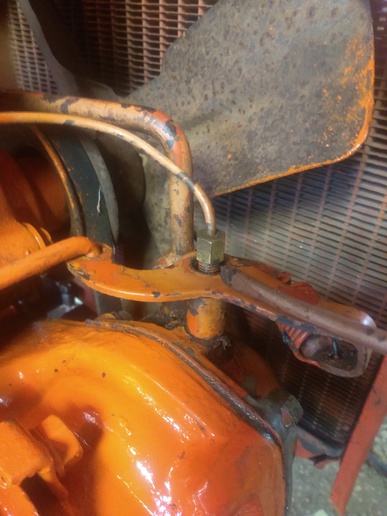

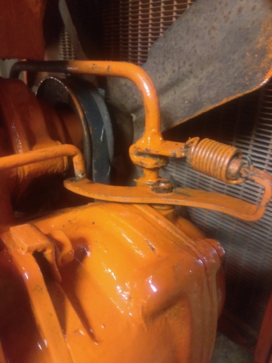

The old motor has good linkage on it. The " new" one s having issues. It just won't move at all when you move throttle lever, until you get wide open then it moves and cross over bar hits fan blade. I think it's rigged up. Can I swap em? Looks like 4 bolts? What's gonna fall out? What's will need adjusting? Or just unbolt one and bolt it in other motor? Thanks!

Old one. It had an oil fitting. New one doesn't. Just cap it? I don't remember where line ran from

First of all, it appears you have some 1939 or so linkage combined with 1944 ? or so gov spring linkage. That will NOT work. The 39 linkage had a very short and stiff governor spring. The newer spring was like a CA/D10-12/D14/D15 and had a plunger inside of the spring to idle the engine down fully. You can't have a 39 cross arm/fork and a newer spring or vice versa. Bending the cross arm to clear the fan is OK, but just barely clear the fan and then you will have to bend the link rod from the arms end to the carb to get the governor synchronized to the carb. Engine off and hand throttle wide open, the length of the link rod should be exactly correct so when you unhook it the cross arm doesn't move.

Dr Allis , you are correct, I tried swapping springs to see if it would help. It did not! Good eye!

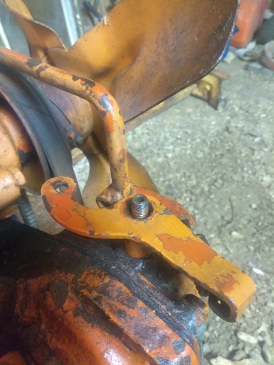

Dick L, covers and linkage switched. It appears to be working. Under this oil line should there be a nut to hold the arm down?
Or some washers as spacers?

Great! They don't have a nut. It looks like the is higher than most. If it seems to ride up a washer wouldn't cause a problem. The spring will tend to keep it in line with the cross over arm as long as the pin doesn't wobble in the cover.
