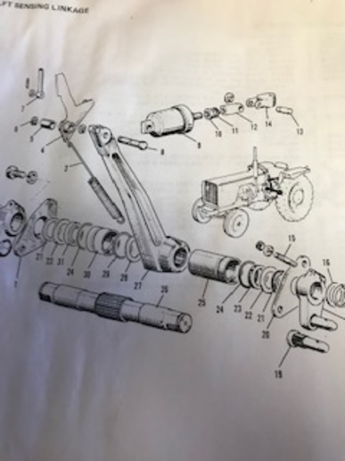

I have an Allis Chalmers 160. Have a leak from both sides of the lower draft sensing linkage. I haven't been able to find any of the seals that I need to fix this. Anyone have any ideas? Thanks.

Good points. I agree with you that lip seals can be matched up or work arounds found. It will be great if you can help him with the seals. As you posted it looks like matching will need to be done by either by numbers he might find on the seals or by measuring them, if he doesn't go to a dealer. I tried finding/crossing the seal numbers in Timken, Federal/National and SKF/CR. Only one of these is described as a lip seal in the 160 parts catalog. At the risk of being wrong I think some of the other "seals' may be O-rings or synthetic rings, possibly not lip seals. Maybe a hydraulic shop could match them. #31 is called out as a "lip seal", #21 is "felt seal", #24 is "seal, bearing", and #24 is just called out as "seal".
The other thing we don't know is can the tractor be down while parts are searched for/matched up vs having the parts in hand to try to minimize downtime.
I bet you're right. That o-ring shown there might be the culprit. I'd probably pull the arm, then the plate and see. If that o-ring goes on the outside of the bushing, that may be tough to refresh.
