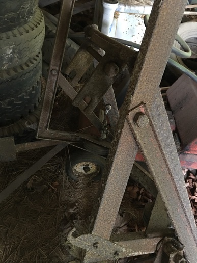

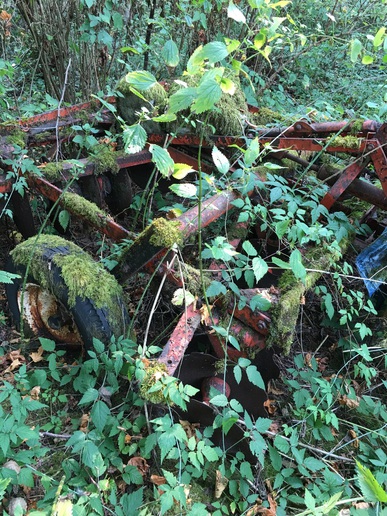

He has an excellent 10 foot disk with remotes and all, snap coupler. It is in sorry shape in the underbrush, but could be easily made perfect, he forsightedly raised the disks off the ground so the only real rust damaged parts are the wheels and the snap coupler drawbar (it's underground so probably dodgy (I just happen to have another though)). I offered to buy it to save it because he has no use, but he countered with he'd give it to me to restore and keep until he needed it. I don't know about that, because I've always held it as a matter of honor not to have other people's things in my possession, but I might do it because it is a snap coupler piece. I have no use because my mounted 8 foot is perfect for my needs and the 10 foot is a bit large to actually use in the hilly property around here, but saving it from destruction might be interesting. Transporting it could be difficult though since it's a wide load. It would be a nice piece to go with my tractor, and something large enough that the D17D could play with. Totally fell in love with it.

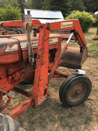

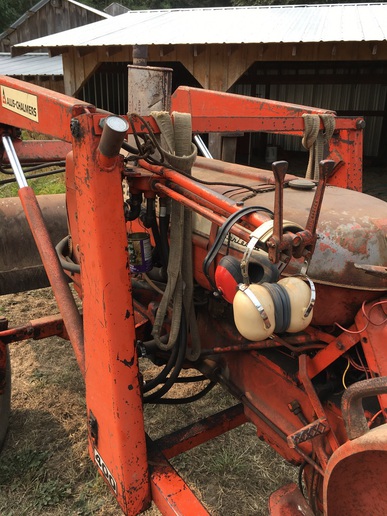

Just because there was discussion on the 400 series loaders on here recently, I snapped a few shots of it. Interesting thing was that it uses a front mount pump and I'd thought only the D17 was fitted with that for 400 series. I'd thought the only 15s with a low pressure separate pump were the industrials. It's all clearly stock though.

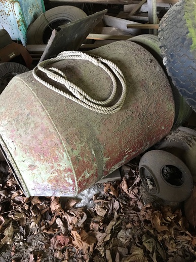

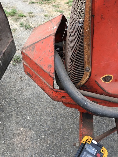

The last thing was the cement mixer which the original owner told him was factory, but it seems like an aftermarket. He built his house with it. The mounts were persian orange at one time, but the main part of the mixer was red. The mounts looked factory and I tried to get a shot of them (was dark in the shed). They were made for the rear lower PTO brackets so it was at least targeting the D-series in it's manufacture. I wish I could have gotten it out into the light.

Just looking at your photo again, it is identical, has the left hand tower sump, you can make out the filler pipe to left of the photo.

Yes, definitely factory installed, very clean job.
The sump on this was the lefthand tower of the loader. One of the photos shows the fill tube (can over it) and another from the front shows both towers, you can see how the right hand tower is hollow and the other is welded shut.

Also that 400 series loader is interesting. Is that a factory pump guard/shield? That one I found on a friend's WD45 in a barn had the crank shaft pulley pump installed as well, but it also had an extra oil sump looking deal on the right side by the brake pedals in front of the fender. You can see it on the right side here, sorta.

Didn't even notice the air cleaner was on the "wrong" side until you mentioned it (3rd photo in the loader series).

RE; D-15 series identity. Air cleaner stack in LH hood and oil bath = series I. Air cleaner stack on right hand hood and dry air cleaner = series II
A person wanting to put a loader on a D-series had to make a choice. High pressure with one way lift cylinders and trip bucket, or high flow lower pressure system if he wanted a hydraulic bucket such as installed on your friends tractors. Seen the system on every D series except of course the series 4 17s and 21s that already had high flow systems.

I should have taken a better shot of the front. The mounted portion of it was the upper section of the hitch and it had two adjustment levelers. The forward one determine the angle the lift arms grabbed the rather heavy hitch assembly, I presumed this would allow it to lift some of the weight if a traction booster sensed slippage. So even though it had remotes and transport wheels, it was as if it were mounted too, only not enough to pick it up, just to grab weight without impacting the angle as my 8 footer would do. Looked ingenious but complex.

We had a transport disc like that, but it was a regular drawbar hitch. I had assumed they only made them with a snap coupler hitch if they were fully mounted. Yes, those loader set ups could be had with the aux. pump and valve. I didn't realize until recently, when here we found out AC made one for a WD/WD45.
And, most interestingly, reading a D15II operators manual, I discovered there was available for the D15II a complete aux hyd. system, much like the D17IV.

When I started faring in "72 I bought a 12 foot wheeled snap coupler disk. It used the lift arms and was very hard to turn. Eventually I put a straight tongue on it, and without the attachment to the lift arms, it did not have weight transfer.

On the front pumps I have a D19 with a factory front pump tied into the tractors hydraulic system and have had a D14 with a set up like you pictured.Also my I-600 has a front pump and hydrastatic steering.
