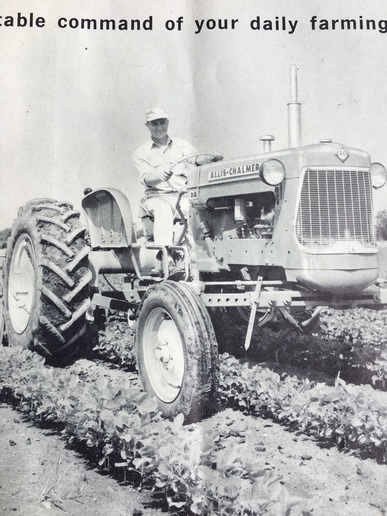

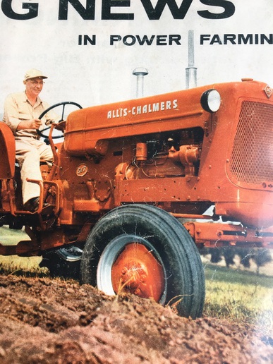

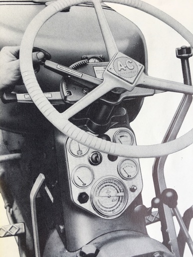

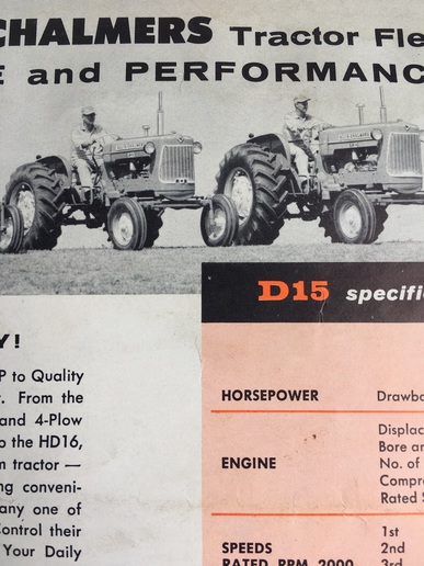

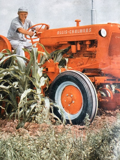

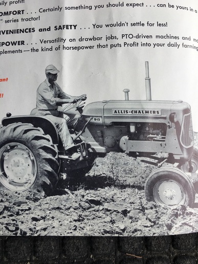

We have a fairly extensive brochure library at one of the warehouses. Today I went there and shot a few pictures for my D15D restoration and picked out a few others that were interesting to me and the immediate machines I am working on. I thought I'd post those for others interest. Let me know specifics of any other models you might want and I'll see what I can do. It's mostly older ACs. We have a lot for other brands too.
What seemed interesting to me in these was:
1. B from early 50s. Note black starter, orange fronts (no silver), B shroud decal placement, and bullet rear light. I restored mine to this standard even though it's a 51 and this is likely 52 or 53.
2. D17 and D15 decal placement on some photos. Same year different location of the D15 decal. Note in the group photo, it's in the middle of the hood, yet the other photos have it in the more traditional tank position. I cut out the D10 and 12 in the photo, but they also had a D decal in that position. Probably 60 since they had black bar and cream grills.
3. Also weird in that same photo is the front badge has the AC in black.
4. The earlier D17 photo shows a very strange D17 oval decal. That is a colorized photo and I saw the original black and white in another brochure, oddly, that oval decal had a white background, I've never seen that, they colorized it to orange. I'm guessing it was a pre-production mockup decal.
5. Note the orange steering wheel paint. On most original photos, it's in black except for prototypes which appeared to always be orange.
6. D14 has front lug bolts in silver and orange air stack, only time I've ever seen that but could have been colorized by a zealous marketing artist.

It was really the D15 that got me digging through the brochures.
Yes, seems like it's hard to say "always" with how any specific year would be painted or where the decals would be. I decided to go with no Even though colors are harder to discern, I prefer the black and white photos because no artistic license would be taken in the colorization.

Yes, to my knowledge, only 57-58 would have had that. After that they moved the model number to various tank and hood positions.

It would appear that most, if not all photos were taken in black and white, and colored later. Add to that, that AC was fond of making little running changes without any designation, or documentation at the time.
It's hard to see in the shadow, but the first picture shows the belt pulley control knob.

Gotta love the picture of the D-17. I grew up on one. (Didn't have the oval decal though)
