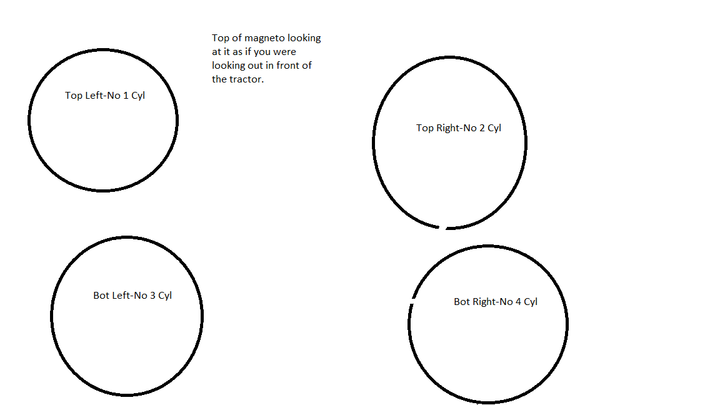

I looked at the firing order, assuming it is 1-2-4-3, (ive lost my book and have no way to verify this), I believe the firing order and spark plug wire order is correct. Assuming the pictures I try to post show up i will give you the views as I see them and what i think it is. Is this correct? All the help is appreciated. When i got home it was dark and i was unable to do the compression test, although from the sounds that isnt an issue at all. Should have a new battery for it this week also. Been connecting my truck battery to the battery cables. Truck battery is a JD batt rated at 690CCA.
Thanks,
Greg

The firing order is correct but that is a magneto and has nothing to do with 12 volt or 6 volt. They make their own power. Did you hook 12 volt to the magneto somehow? Did you have the magneto off?

I seem to be an assumption kinda guy. I reread the original post. I took the 3 set for three months as it ran 3 months ago. I take it now that it has not run since you have had it. If it has not run and has spark then timing of spark to the proper plug and carburetor would be where I would check now. Spark to number one plug has to be on the compression stroke. That is when you can feel air exiting number one plug hole and both valves to that cylinder is closed. When you are sure of this then a mist of starting fluid will tell you if you have a carburetor problem.
