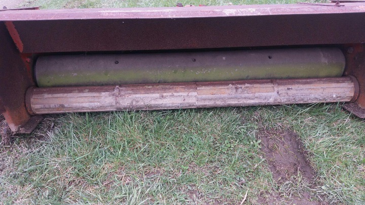

I am looking at picking up a Allis Chalmers model 500 hay conditioner. I am not real familiar with this piece of equipment. I am needing something to crush the steps on our heavy clover to get them to dry down for hay.
Is there anything I should watch out for on these?
Are the rollers both metal? They look like they are from the pics but I havent seen it in person yet.
Do they do a good job of crimping the hay?
Are parts available for them?
Is the roller gap adjustable?

A friend of mine has or had one of those and parts can be hard ot find for them and cost a lot. If I where you I'd look for a New Holland one since at least in my area they are very common and parts are easy to find
Don't see hardly any of these around where I'm from. I'm trying to get it for $200
Did they do a good job of conditioning the hay?
WE use to rent one from the dealer, and it worked great on sweet clover, [ yellow blossum ]we put up at least 80 acres every year, Get it fixed you will like it, and so will the cattle, like that clover. One year we ground some of that clover hay with a little oats added,nice and green, they would knock u over for it!
It did do a good job when we could keep it working but had problems with the belts ad some other such thing but then again it was old and came out of a fence row.
I was in high school when we use to rent one,cant remember for sure,at least i never had to tighten them, but apparently you can adjust the two roller's together, because you could hear it pound back there if the swath was bunchy. It always feed thru there too, never plugged it.
