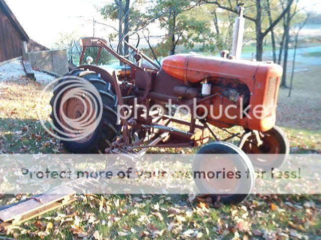

here is the one I use... maybe 2-3 times per year for 2 hours each time.

One problem your going to find is the mower is heavy to lift when using. Adding a hydraulic cylinder will help to position the bar height. Also the mower and cylinder run off the same PTO hydraulics, so you have to raise the mower while the mower is running. Not a problem , just something to know......... last problem is to "PARK" the tractor you get off and raise the bar and pin into position. Probably a good load for 80 years old.
