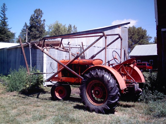

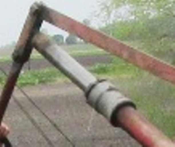

There is a "36 WC on the farm in MN that has been in the family since "37. It has a aftermarket trip bucket loader on it supposedly installed in 1946. Loader has a PTO powered pump with a control lever and 2 large cylinders (about 2-1/2" dia rods and total OD maybe 4"). What I remember my Dad (passed 2yrs ago) telling me about them long ago is they have pump packing for seals. These things always leaked a bit and once in a while, Dad would put a pair of pipe wrenches on and tighten the big nut at the top. He used to use 50wt motor oil too. I"ve been using the loader around the farm on occasion and the leaking from one cylinder in particular is pretty out of hand. Darn near a steady stream sometimes. The nut does not want to tighten anymore and I am supposing that the packing material is simply worn away. Is there any guideline info as to what is in these things and how to take this apart and where would I get the "rope" or whatever goes in there? Is this a big project or am I better off buying 5gal of oil and trying to keep ahead of the leaking for the few times I use this?

Couple of pictures of the tractor and loader.
2 summers ago. Good view of the whole loader and the pump.
Detail of the end of the cylinders. That "can" threads onto the end of the "pipe". It is some sort of casting so far I can tell as there is a mold parting line. There is a "nut" at the top that threads into the can. I would imagine that this rope stuff must be under the nut.

Baum Hydraulics in Omaha will have packing for that. Back the nut out and pick the seals out. Try for a chevron type seal with the od and id of the opening you picked the seal from. They will come in a set and if you can't get the cylinder apart, you can cut them on an angle with a razor blade and offset all the cuts, wrap it around the rod and slide together, tighten the nut not real tight and work cylinder and retighten til leak stops. Have done lots of them.
They're probably a 3" cylinder from your description. The lifting power would be alot more im sure if the cylinders were repacked. Usually if the rams leak outside the inside is internally leaking horribly.does the loader drift down?. If so your piston seals are out too. If you take them apart you should be able to find replacment parts that will work. If all else Google hydraulic cylinder parts and you will find many places that can supply modern seals by size and type..
Those appear to be single acting cylinders with the hydraulic oil entering at the bottom. Typically there should be packing at the end of the ram and little or no oil should be getting past it to the top end of the cylinder to leak past the packing. If oil is getting past the ram packing into the top end of the cylinder then without a return line at the top of the cylinder there is no place for the oil to go other than to push past the packing at the top of the cylinder every time you raise the loader. I would take one cylinder off and completely dismantle it to properly find replacement seals and packing that you need.
