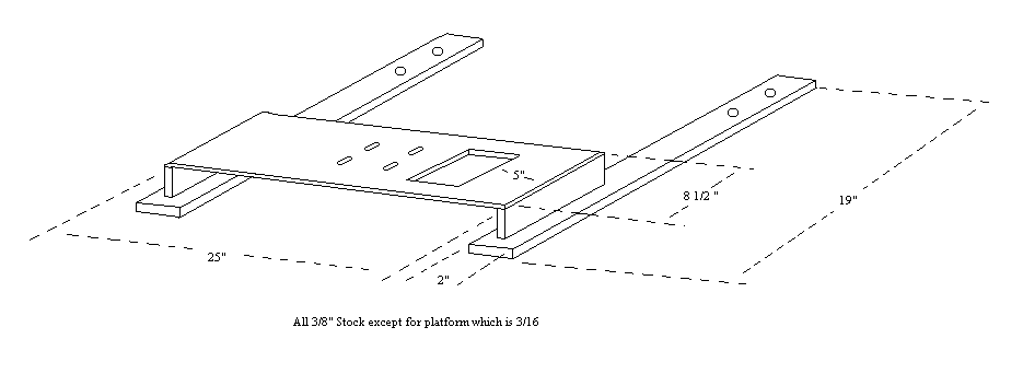

The general idea was in my mind and to be honest, I started cutting and welding without preparing an official engineering drawing and in my defense I kind of doubt many of those farmers in the 30s and 40s had access to AutoCad or a drafting table for that matter. After the fact (in reality while writing this article), I did prepare the drawing and recommend this for any project that you want to come out right the first time. Since our readership is online, 99.9 percent of you have the tools to draw out the projects you can imagine, even with Paint, MacPaint or... even pencil and paper.
The basics were simply a platform that would hold the grinder high enough that a garbage can could fit under the exit chute, would allow clearance for the belt, have adjustment to keep the belt tensioned and would not be too high to pour buckets of grains in. This design was made pretty easy by having the angle iron fender and hitch mounts common on both the little Pony, the Earthmaster and the A-Cs. The other rear pulley tractors that come to mind would require significantly more effort to design stable mounts unless struts were extended to the drawbar (making it less useful during non-grinding operations). We opted to try using the flat belt pulley instead of replacing it with a v-belt pulley compatible with the pulley on the grinder. Though we were taking a chance, we found that the V-belt pulley on the grinder plus correct tensioning kept the belt in perfect alignment and the additional hassle of locating a V-belt pulley for the Pony would have been a needless effort. With the author's apologies for a decided lack of sense of proportion, here is the plan.
diagram of plate to hold grinder

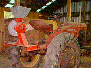

Using the drilled angle iron to hold the platform makes it a simple matter to attach the mounts. The two inch uprights raise the platform sufficiently for the collection can clearance. The holes were drilled with an electric drill and the cutouts made with a small angle grinder. The slots that allow adjustment in belt tension were made by drilling two closely spaced holes and using a carbide burr in the drill to take out the material in between. The chute cover was critical to keep grain headed downward rather than hitting the platform and flying all over the floor. Both the chute bottom and top were formed on a railroad tie by simply using C-Clamps to hold them and hammering the bends with a ball pein hammer. The bottom was welded to the platform but the top cover was simply bent by hand slightly over a 45 degree angle such that the sides have pressure against the bottom (it has never fallen off). Guards were formed by cutting a plywood form and peining the edge over with their mounts being simple bar stock welded on and bolted to the platform.
As mentioned in the original fabrication article, the drill and angle grinder are basic necessities but the welding could have been farmed out for pocket change. If, in fabricating such items, you decide to purchase a welder, its important to mention that, on this project, even the sheet metal was welded with an inexpensive "buzz box" AC welder (This is apparent by the weird looking welds in the pictures but it is still strong and shows no signs of giving up after hard use). If appearance is not an issue, as is the case with working-tractor projects like this, one can get by with very small mild steel rods and very low amperage. If appearance is an issue for you, such as a replica component for a restoration, then the welding must be farmed out or you have to spend the big bucks for a wire feed welder.
When all was said and done, we had about 3 hours into making this mount and no more than ten dollars in scrap steel and welding rod (well... that doesn't count the 3.95 for the IH Red Poof Can paint) and it really works. We have friends that have come up with innovative and inexpensive ideas along this line with my personal favorite being a Farmall H that will drive an ice cream maker for use at benefits. With our project, there was no better feeling than finding a use for this very old technology and saving hours of work in the process... and we made it ourselves.

Massey-Harris Pony with Grain Grinder attached to Belt Pulley
WARNING, Guards are not mounted for the purpose of showing belt placement and mounting, never fabricate or use belt accessories that do not have completely covered belts and pulleys. Even with pulleys in place, never operate such equipment with children or animals present.
