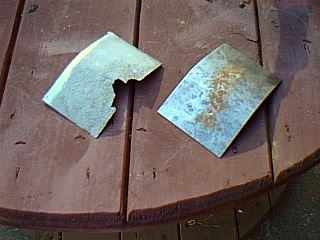

  • Cut out a section of the same thickness sheet metal. The big mistake I have seen here is attempting to use a slightly thicker or thinner replacement piece. Doing so will result in a poor joint. Below is a picture of the piece of bad sheet metal next to the replacement section.
    patch panel to weld in
