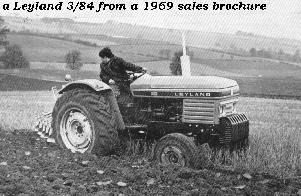

The B.M.C (British Motor Company) had been bought out by "British Leyland" by 1968, but at the royal show Leyland promised to keep the "Nuffield Tractor" line and disclosed plans to consolidate and expand it. After a year of designing and testing, rumors of a new " big" Nuffield tractor started to filter out of the Bathgate factory. In November 1969 three new machines were unveiled, however the Nuffield name along with the poppy orange and white livery had been dropped. The name had changed too, the tractors were now labeled "Leyland" (Nuffield) although the Nuffield was relegated to being a small sticker above the model number. Even this was to disappear the following year.
1969 Leyland The Leyland 154, 344 and 384 machines were now painted 2 tone blue with silver wheels, the engine gearbox and hydraulics were dark blue, whilst the bonnet and mudguards were light blue. The 384 was powered by a 70 hp, 3.4 litre 4 cylinder diesel engine, which apart from the addition of a harmonic balancer on the crankshaft to alleviate the vibration and a small increase in power was similar to the 4/65. However the restyling improved the machine no end. The instrument panel remained the same as that of the 4/65.
The Leyland 154 was the same as the Nuffield 4/25 apart from the change in color and three bars added to the front grill. In 1969 the retail price of the 384 De-lux was £1,186. The 344 De-lux £1,080 and the 154 De-lux was £680.
The 384 model number stands for a 3.8 litre engine of four cylinders, the 344 3.4 litre engine with four cylinders and the 154 for a 1.5 litre four cylinder all of which remained unchanged until 1979 when production ceased.
