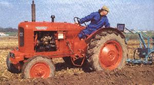

Picture of a Nuffield Tractor
First shown at the Royal Highland show in June 1954, the OEA 2 engine, has a 5 main bearing crank shaft and was of a direct injection type it was fitted with wet cylinder liners and aluminum pistons. The crankshaft is driven by a triplex roller chain, it was a 3.7" bore and 4.724" compression, ratio is 16.5:1 and normal operating speed range of 1,000rpm to 2,000 rpm. The injection pump was a "SiMMS" inline SPE4A/755 and had a built in pneumatic governor, serial numbers for a 4DM started at DE 1001 to DE 106387.
