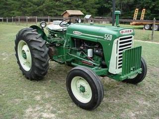

Oliver 550 Clutch Overhaul Tips
by Greg Sheppard
Oliver 550
I got my 1964 Oliver Model 550 (Serial 141-139-519) second-hand and used it for several years before the clutch began to slip. After taking up the pedal linkage several times I saw it was going to take more than that. The engine had been leaking oil at the rear seal and I suspected oil was causing the driven plate to slip, so I decided to replace the crankshaft oil seals at the same time I overhauled the clutch.
Allow yourself plenty of time... After buying a new clutch plate and new cork oil seals (from Korves Brothers) I pulled the engine, expecting to finish the job in a week or so. That was a bad guess. A lot of parts were caked with dirt and I couldn’t bring myself to just put them back that way. Then it seemed a shame not to paint things while they were clean and accessible, and so it went. It’s a tricky job, and this was my first one, with only a set of (sometimes cryptic) Oliver Service Manuals for guidance. On top of all that I found some problems I didn’t know I had and took time to repair them too, making a bigger job for myself than may be necessary for you, but even so I caution against tackling this job on a tight schedule.
