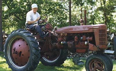

Picture of Farmall C
Photo contributed by Paul Shuler.
In 1948 the first Farmall C tractor rolled out of the factory and into the farmer's field. A follow-on to the Model B, it was slightly larger in size but kept the same 113 CID engine and 4-speed transmission. Other upgrades included adjustable rear tire spacing (with sliding hubs), a frame design similar to the larger Farmall Models H and M, and International Harvester's new "Touch Control" system which allowed the operator to lower and raise implements by touching one small lever. The tractor was very versatile and was used primarily on smaller farms or for small jobs on large farms.
The Farmall C was produced from 1948 to 1951, when it was replaced by the "Super C". Approximately 79,836 Farmall C tractors were manufactured. The weight of the tractor (without water or fuel) is approximately 2,780 pounds. In early 1950, a handful of these tractors were delivered to dealers with a white paint scheme as special demonstration models.
