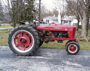

near death farmall
The "Near Death" Farmall
A friend of mine emailed me in February 1999 about a 1951 H, located just northwest of Louisville in Southern Indiana for $500. He thought it was in pretty good shape, ran OK but smoked somewhat, and sent me some low resolution digital pictures. The H appeared OK but pretty dirty from the pictures. I sent him a check for $600 so he could go ahead and pay the owner, change the oil and filter, purchase a new battery, battery cables and a IH muffler assembly.
MARCH 1-MARCH 7, 1999. I had my retired mechanic friend Bob Lamb, who now resides in western Indiana, haul it back for $175. He was not cheap but he is insured and has a heavy duty trailer. The tractor arrived in Indianapolis on Monday, March 1, 1999. I had to do some temporary wiring on the ignition so I could start her up and get her off the trailer. That is when I discovered there were no brakes! She started pretty easy but I could tell 2 cylinders were not firing at all.
Appearance wise the tractor was in poor shape. The previous owner had done some token painting on the hood, the cover and the main wheel hubs. The main tires consisted of one worn 10” H rim with a 12.4 X 38 Firestone tire. The other rim was a 12” M with a 13.2 X 38 Firestone tire. That tire stood at least 2” higher than the smaller H tire and had 2 nasty cuts in the side wall. There were no lights and the seat assembly was in terrible shape.
I spent the afternoon changing the 90W in the transmission. GOOD news was that only 90W oil drained out. There was no water or bearings, etc. in the oil. I replaced it with 85W140. I also cleaned the spark plugs. #2 had an extender on it so I was suspecting a little bit of oil burning. I reset the point gap to .20 and adjusted the timing to where I thought it would run OK I also tightened the fuel strainer nuts on both the cutoff lever and the pipe connection. It was leaking badly.
On Tuesday, I gave it a start. The GOOD news was that it fired on all 4 cylinders. The BAD news was that it was smoking terribly. At this point I knew I had a real big mess on my hands. I ran it 5 minutes and placed her in the garage for the night.
On Wednesday morning I filled the radiator with water. I no more than had it half full and I had 5 leaks develop from the radiator. That is when I decided I would pull the head and seriously assess the tractor.
That evening I removed the head and found a terrible mess. The valve guides on #2 and #3 cylinders were leaking badly. The pistons were caked with burned oil. I could freely wiggle the tops of #2 and #3 pistons so I knew the rings were badly worn. I spent the rest of Wednesday and Thursday cruising the web and pricing parts and taking an initial assessment of whether to proceed with a rebuild or part out the tractor. I had done paint and parts restorations on my 1945 H and a 1944 H I no longer own. I thought it would be a challenge to do an engine rebuild with 6 year old daughter Corey helping as much as she could. I had already told her it was her tractor. The last engine I rebuilt was a VW engine in my college dorm in 1973.

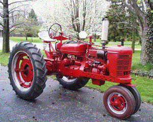

almost restored Farmall
Almost Finished, Waiting for New Tires!
By now I have the 3 light assemblies painted and ready to install. The key to having the lights work is having a good ground from the light housing base all the way to the decking. I did not do a good job on my 45 H and consequently I have ground wires. I made sure the bottom of the steering post was filed cleaned before I re-installed. I then filed the steering post and the light bar clean where the 2 clamp together. I filed the light bar ends and filed the inside of the light clamps. I also filed the light spacers on both ends. Taking my time, for once, paid off. On the rear light assembly, I purchased a longer bolt. Just as I was tightening the rear light bracket down, the bolt began to bind. Instead of backing it out I made the fatal mistake of tightening it with a 2 foot break bar. BIG MISTAKE. The bolt sheared at the threads. So I tapped the 2 inch deck hole with a ½-12 tap and used a 2 ½ inch bolt. The light works fine.
During the week of April 19th., I lowered the liftall, using 4 threaded rods and nuts, and installed the new countershaft seal and the pump gasket. I painted it and installed on Saturday April 24th. The GOOD news was that the liftall did not leak. The BAD news is that I didn’t get the cam and piston valve lever hooked up correctly to the control shaft. So the liftall came down again. I called Bermuda Ken Updike for 2 more gaskets along with another PTO seal and PTO base gasket. The PTO is leaking slightly at the base.
When I got to hour 7 on April 23rd., I decided to pull the valve cover again Saturday morning April 24th. I was convinced I had improper valve clearances. I re-torqued the head bolts. This time only the bolts around #2 and #3 cylinders had slightly loosened. On the valve clearances, #1 exhaust was not closing tightly. #2 and #3 valves had .40 clearances. #4 clearances were pretty close. This time I carefully watched the exhaust then intake valves open and close. I then cranked by hand so the flywheel mark was on the timing pointer for cylinders #1 and #4, and that the mark was 180 degrees opposite (i.e. down) for #2 and #3. I did several passes until I was thoroughly convinced I had the clearances correct. This turned out to be a wise move.
When I started her up she was definitely running on all 4 cylinders and had that sweet humming sound of a good running H, except for a noticeable ticking noise. I did more adjusting with the carburetor and the timing and I could tell I was getting it close to normal operation. The rebuilt governor was responding perfectly. I did some road gear running and found the front end solid as a rock. There was no wiggling of the front bolster at all. For the heck of it I drove the H down a busy Indianapolis highway and filled it up at the Marathon station. The attendant is still laughing to this day. I had to limp home in 4th gear because both front rims got loose on the hubs. When I got home I tightened the hub bolts and nuts with a 2 foot break bar.
On Sunday, April 25, I disassembled and cleaned the carburetor. There was a lot of dirt in the passages and of course the filter was missing. The generic carburetor kit was less than desirable. I sheared off the new idle metering tube while installing. I was able to take a numbered drill bit and successfully drilled the sheared tube out and reused the old metering tube. The 30 minute job took 2 hours. I could not use some of the parts that came with the kit and it did not have the filter assembly. I installed the carburetor and fired up the H. I got the high speed mixture set quickly, but I could not lean the idle all the way. To compound the problem, the new choke rod was so loose that I have temporarily installed a wire from a governor plate bolt to the choke lever to keep it open. I have since purchased 2 carburetors from Cowboy Ken for $80 and ordered an IH kit from Ken Updike for $65. It is suppose to be a complete and thorough kit. I also changed the oil and dropped the pan to clean out the ring dust and some sludge. I used Permatex on the oil pan gasket which stopped almost all the leaking around the oil pan. I also changed the filter which was about half loaded with sludge.
APRIL 26-MAY 2, 1999. I have ordered new Firestone tires, tubes and painted main rims from M.E. Miller Tire. They should arrive by the weekend. Total cost including shipping was $1,125. I will have 2 used main rims to sell. I have also found the source of the ticking sound in the engine. The oil pressure gauge fluctuates in rhythm with the RPMs. I suspect a chipped gear tooth on the top pinion gear. So I have ordered a used oil pump from Gary Biewer. I will swap pumps at hour 30 when I change the oil and filter again. I also have to rebuild one of two carburetors I purchased and install it.
PROBLEMS TO CORRECT. Almost nil. The rear engine seal is leaking about a tablespoon of oil per running hour. I will eventually have to split the tractor and replace the rear seals. I may also have to replace the timing gear cover gasket. It is leaking slightly. I still need to purchase a generator and mounted voltage regulator. There is a generator shop in Indianapolis that specializes in the antique generators and regulators. That will cost around $150 for a 12 volt set up. I will have to drain about 3 gallons of 85W140 from the transmission case before replacing the PTO main gasket.
