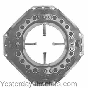

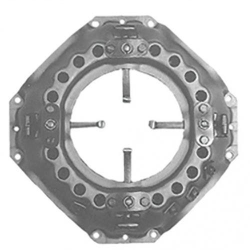

  • For Ford tractor models TW5 (1983 - 9/1985), TW10 (10/01/1975), 5110 (1982 - 9/1985 and 4/01/1988 - later), 6410 (1/01/1988 - 11/1991), 6810 (1982 - 9/1985 and 4/01/1988 - later), 7810 (1982 - 9/1985 and 4/01/1988 - later), 7910 (1982 - 9/1985 and 4/01/1988 - later), 8000 (1965 - 9/1975), 8100 (1965 - 9/1969), 8200 (1965 - 9/1975), 8210 (1982 - 9/1985 and 4/01/1988 - later), 8400 (10/01/1969 - 9/1975), 8530 (3/01/1990), 8600 (10/01/1969 - 9/1975), 8700 (10/01/1975), 9000 (10/01/1969 - 9/1975), 9200 (10/01/1969 - 9/1975), 9600 (10/01/1969 - 9/1975), 9700 (10/01/1975)
  • Replaces Ford OEM number D8NN7563BA
  • Pressure Plate Size: 13
  • Pressure Plate Levers: 4
  • Pressure Plate Springs: 16
  • Pressure Plate Type: Single Stage
  • For a New version of this sku use Item #: 169921
  • Condition: Remanufactured
  • Core Charge: $40.00 (refundable)
  • Additional Shipping: $10.00
