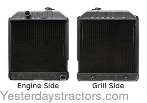

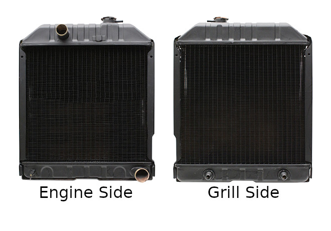

E1NN8005AB15M Radiator E1NN8005AB15M
This is a New Radiator with oil cooler connections. It is used on Ford New Holland models: 3230, 3430, 3610, 3610N, 3610NO, 3610V, 3930, 4130, 4410, 4630, 260C, 340, 340A, 340B, 420, 445, 532. Measurements in inches: Overall Height: 22 1/2, Overall Width: 19, Core Height: 16, Core Width: 17 1/4, Depth: 2 1/4, Rows: 3, Fins Per Inch: 8, Fill Neck Height: 3/4, Inlet: 1 1/2, Outlet: 1 3/4, Oil Cooler: 45 Degree Flared Fittings (7/8-14 Threads) on 10 inch centers. Replaces OEM numbers: 82847505, E1NN8005AB15M
