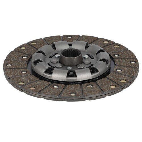

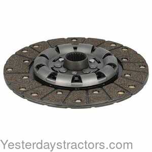

Allis Chalmers D12 Clutch Disc, Remanufactured, 70237137
Allis Chalmers D12 Clutch Disc 206307
  • For Allis Chalmers tractor models D10 (s/n 3501 - later), D12 (s/n 3001 - later)
  • Compatible with Allis Chalmers Construction and industrial models I40, I60, I600
  • Replaces Allis Chalmers OEM number 70237137, 70246660, 70248239
  • Clutch Size: 9
  • Clutch Hub: 1-1/4
  • Clutch Spline: 24
  • Clutch Center: Spring
  • Clutch Type: Woven
  • Condition: Remanufactured
  • Core Charge: $15.00 (refundable)
Item #: 206307
Price+Core Charge
$117.00 $15.00
$132
Most Allis Chalmers D12 transmission problems can be traced to parts that the average person can change by following instructions provided in the service manual for your tractor. If there is a funny smell coupled with limited acceleration, most likely your clutch is slipping. Try and adjust the clutch to see if this is all that is needed. If it doesn't help, or the smell is accompanied by a scratching noise, you need to replace the Allis Chalmers D12 tractor clutch disc, pressure plate and throw out bearing.
