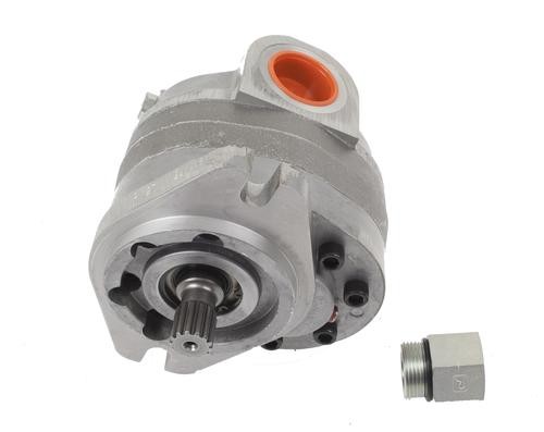

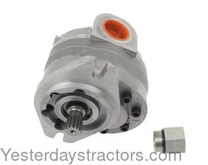

770242529Z Hydraulic Pump for Loader 7702425-29Z
Part Description: Pump, Hydraulic For 730 LOADER, 735 LOADER. SPECS: CAPACITY GPM at RPM: 21.5 at 2000, SHAFT DIAMETER: 7/8 inch, SHAFT TYPE: 13 spline, ROTATION: Left hand, PORT SIZE INLET: 1-5/8 inches-12 ORB, PORT SIZE OUTLET: 1-5/16 inches-12 ORB, MOUNTING: 2 bolt SAE "B", FORD PUMP APPLICATION: 730 and 735 loaders, CAPACITY GPM at RPM: 21.5 at 2000, SHAFT DIAMETER: 7/8 inch, SHAFT TYPE: 13 spline, ROTATION: Left hand, MOUNTING: 2 bolt SAE "B", INLET: 1-5/8 inches-12 ORB, OUTLET: 1-5/16 inches-12 ORB. The 2 bolt mount slots are 9/16 inch and open on the ends. Minimum measurement between the slots are 5 1/4 inches and Maximum is 6 7/8 inches. Reference ID: 7702425-29Z
