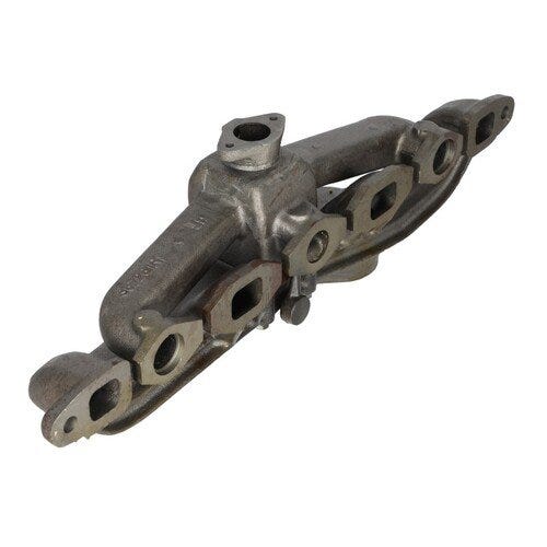

121565 Manifold 121565
  • For International / Farmall tractor models Hydro 70, Hydro 86, 606 (use pipe adapter125212), 656 (use pipe adapter 125217), 666, 686, 706, 756, 766, 806, 826, 856
  • Replaces International OEM number 367281R1, 384290R2, 85699R1
  • Engines: C221 (use pipe adapter 125212), C263 (use pipe adapter 125212), C282, C291, C301
  • Completely assembled 2-piece assembly contains OEM heat spring
  • 2-1/2" NPT threaded pipe outlet
  • Application information
  • This completely assembled 2-piece intake and exhaust manifold is easier to install! Our 121565 2-piece manifold with heat spring eliminates the need to match the flanges of a used manifold to half of a new manifold
  • Please order 113422 exhaust pipe unless you have a 460, 560, 606, 660, 2606 or 3616
  • If you have a 460, 560, 606, 660, 2606 or 3616, then you need an exhaust adapter. Please view: 125212 adapter. This adapter offsets the exhaust hole to align with the hood of the tractor and also steps down the pipe diameter to 2" NPT. These tractors use 126744 exhaust pipe
  • If you have a 656 or 2656, then you can use the 113422 exhaust pipe, however the exhaust pipe is not perfectly centered on the exhaust hole in the hood. Also, you need to have the inlet pipe on the muffler expanded to accommodate this larger diameter pipe or you need to purchase 100824 muffler
  • If you need to adjust the pendulum (121566) on the intake manifold, please use a Torx T8 screwdriver or bit
