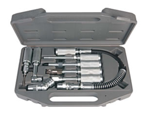

JD cornhead grease is good stuff! Another way to get it through small fill holes is with the rubber tip or needle in the Lincoln lube accessory kit.

Ooops guess they didnt like me linking the pic.
The Lincoln kit, pretty handy thing to have in the shop.
