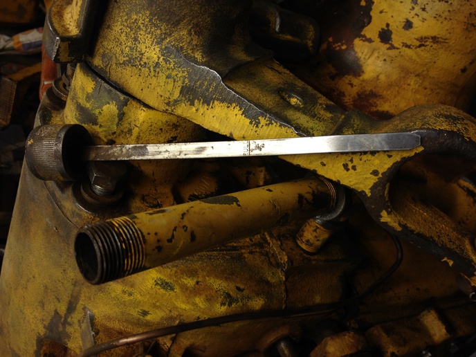

I am new to the tractor line of MM. I have a MM670 that my uncle passed on to me after passing. I don't understand the fluid level between the power steering and hydraulic lift. the power steering fluid reservoir and pump is located at the front of the engine and it is driven by the belt of the engine, is this where I add power steering fluid? or is this where I add hydraulic fluid? I found a fill tube at the back of the tractor behind the tractor seat where fluid can be added, is that where hydraulic fluid is added? im really confused and seek advise and knowledge.

Klw445
11-06-2013 20:20:10
Report to Moderator
 Re: MM670 fluids in reply to bshadrake, 11-05-2013 09:11:14
Thought I'd post a pic of the dipstick on my 670. Wondered if yours broke off in the fill tube. May not help?? By the way, your power steering resivoir should only be filled to just below the point where the container starts to taper towards the cap.

The power steering pump and resovoir are on the right side of the engine. There is not a dipstick on this resovoir. The hydraulics dipstick is on the back of the tractor. I have the parts/repair and operators manuals for the M670 tractor for sale.

im on track with the power steering fluif reservoir and know how to add fluid in the reservoir, on the hydraulic fluid I understand the filler tube but I still do not see the dip stick for checking hydraulic fluid, where is it? is it located close to the filler tube?

The dipstick might be in the filler tube? It is on many of our MM's. On the other hand, my M5 only has a cap, and no dipstick.

I seen in a manual online where it says that for my model of M670 that the power steering and hydraulics use the same hydraulic fluid, im going with that to top off the power steering and hydraulic fluid
