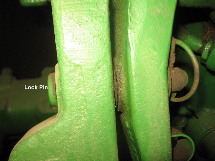

Take a look at the photos below of "BW" our 54 Model 40T.
a256375.jpg" width="650"
Note the selector lever is in the [i:654c4848f0]forward[/i:654c4848f0] position.
a256377.jpg" width="650"
Note the lift arms locked together by the lock pin.
