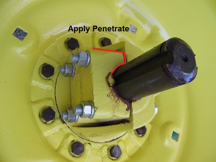

All efforts to free up the axle clamps and hubs on my 420 have been unsuccessful. I have managed to loosen the nuts, but the bolts and clamps are still stuck in place.
Any tricks to get these things loose?

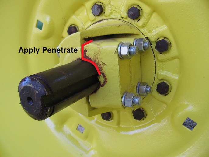

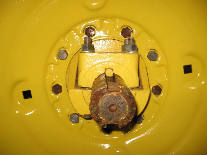

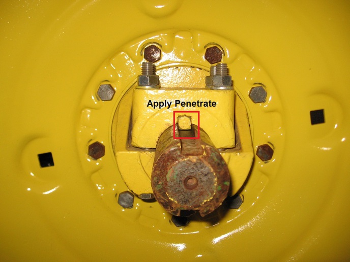

James Howell
01-09-2018 13:53:32
Report to Moderator
 Re: How free-up axle clamp/hub on a 420? in reply to mr.precision, 01-09-2018 06:16:25
"Any other ideas?"
This is one method of removing the rear wheel hub cap.
Please be mindful of common safety steps; expressed or not.
Lift the rear tire and rotate until the rear wheel hub cap is horizontal.
Apply penetrate between rear wheel hub cap and rear wheel hub.
Tap the rear wheel hub cap with a small sledge hammer.
Rotate the rear tire 180o.
Repeat previous three step process several times.
Rotate the rear tire 90o until the rear wheel hub cap is vertical.
Loosen hex nuts until flush with top of cap screws.
Apply penetrate between rear wheel hub cap and cap screws.
Tap each cap screw with a small hammer until the hex nut is flush with the rear wheel hub cap.
Remove all hex nuts.
Apply penetrate to the key and axle key way.
Put a punch on the end of the cap screw and tap with a small hammer.
Repeat previous three step process until each cap screw is removed.
Hope this helps.
[Log in to Reply]  [No Email]
