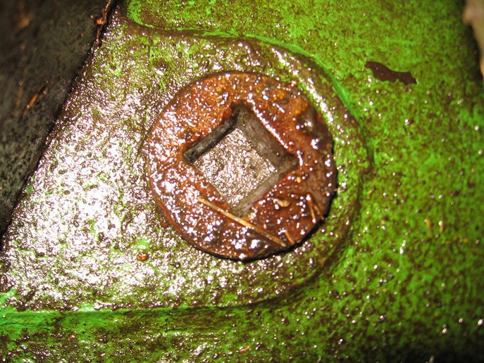

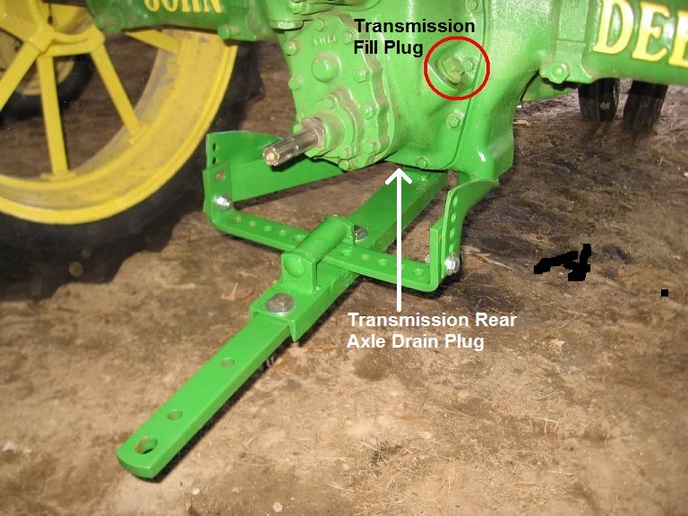

I drained the oil, then started loosening the filter cap. Some water, then what felt like 90 weight. I thought I mike be draining the transmission! A few more questions
Where do I add the new oil?
Where is the transmission drain and fill?
Is there a service manual I can get to answer other questions that will come up?
This JD sure is different than my Ford 641 and my Farmall A....

 Re: More Unstyled B questions... in reply to treeman53, 06-19-2017 10:39:40
"Where do I add the new oil?"
Take a look at the photo below of the breather cover.
Turn the breather cover counter-clockwise to remove it.
Remove the filter then add oil.
"Where is the transmission drain and fill?"
Take a look at the photo below of the transmission plugs.
You might need to move the drawbar out of the way to access the drain plug underneath.
Take a look at a photo of the rear drain plug.
When adding transmission oil, fill to the bottom of the threads of the filler hole.
The operator's manual recommends 4 1/2 gallons.
