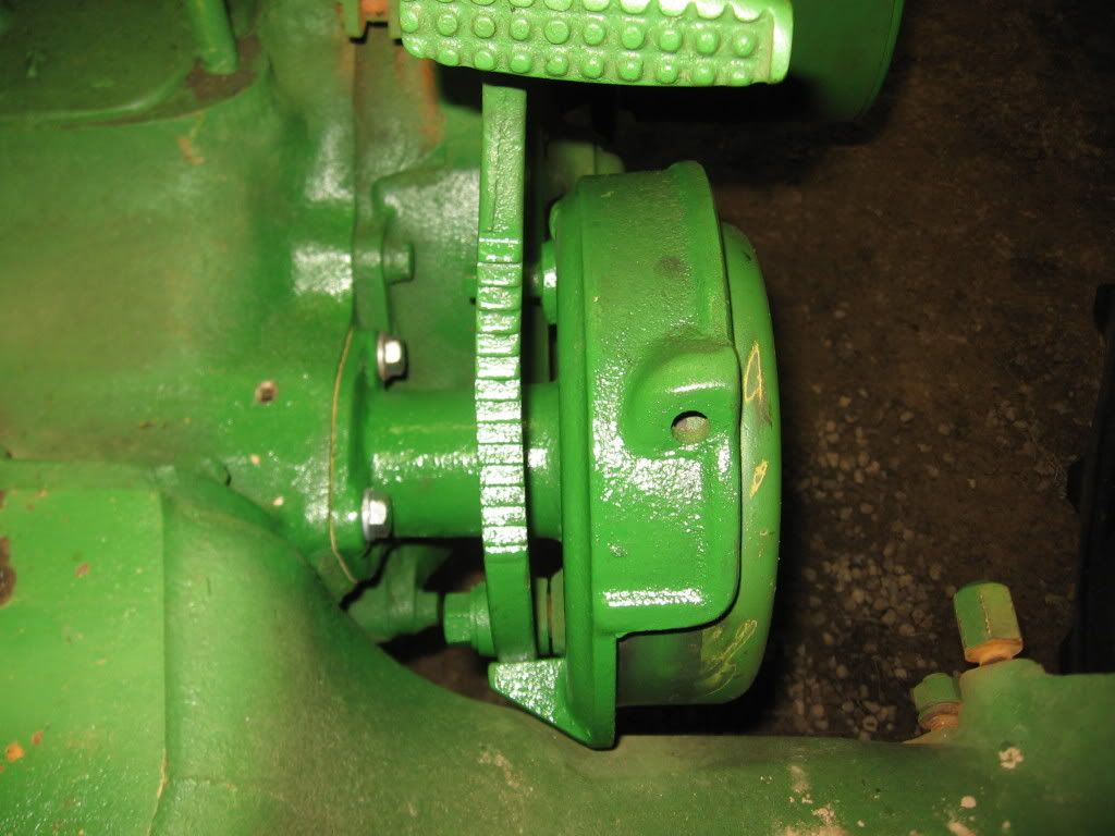

After looking at the first photo of your tractor, it narrows down the year to either 1939 or 1940.
Notice the design/style of the right brake on your tractor.
Compare it to the photos below of the right brake on "Uncle Earl" our 39B.

Your tractor will also have a 4 speed High/Low with reverse.
