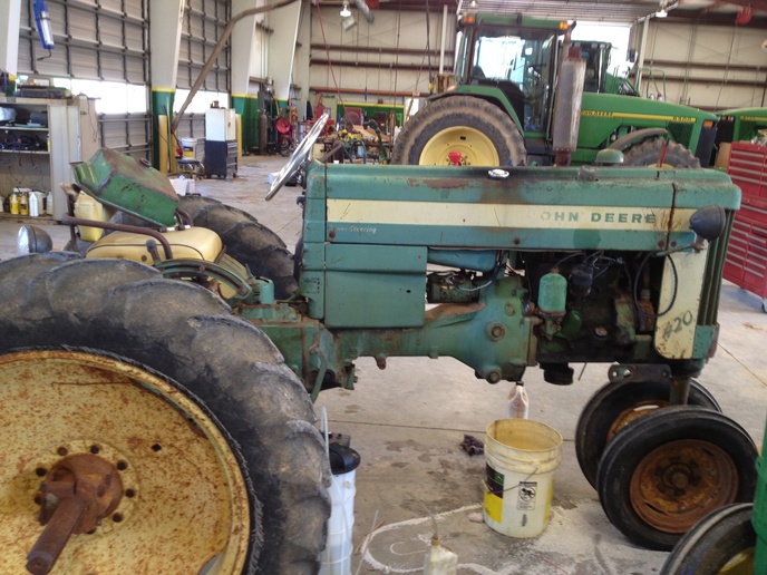

I have a 420t slant steer with power steering and I am having a few problems. I cannot get it to turn all the way to the turn stops in either direction. It wil turn 2/3 of the way to the right but only 1/3 to the left. I can manually kick the tire and get it to go over with pressure,but the steering wheel will not turn any farther. Could the piston be maxed out. Does a power steering machine have less turning ability than a manual steer?

I finally figured out my problems. I took the steering tower off and found that someone has gotten the timing off on the gears on the power steering cylinder. It has timing marks and they were off by a mile to say the least. I am going to rebuild it while off the machine and hopefully everything checks out ok.

Thanks Dave! I have already drained the fluid and flushed it. I cranked the tractor and turned the wheel with ease to the left but it stops and you here the pump load up and it will not turn anymore, but if i take the wheel and push it, it will go furtherand the steering wheel turns. but if i try again to turn on the steering wheel it stops and it acts like the piston is at end of stroke. I can turn 2/3 of way to right and it does the same thing. if it were out of time you would think it would turn all the way in one direction???? Do all power steering units turn as tight as the manual ones?

Here is a picture of my 420t
