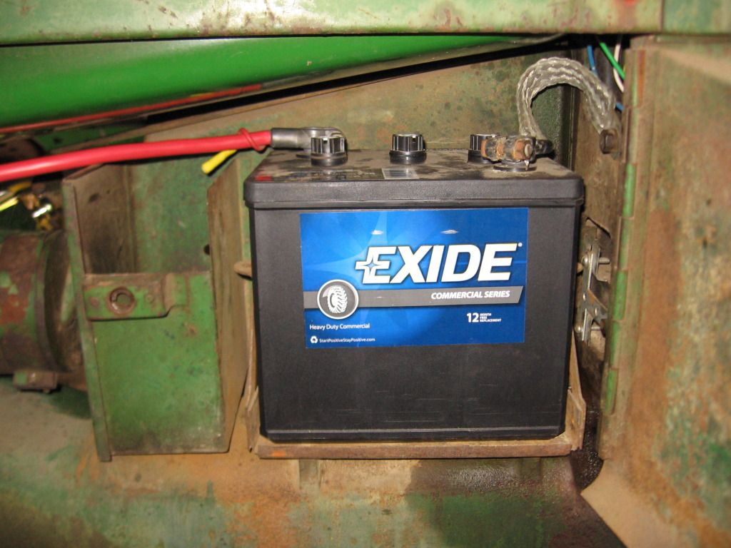

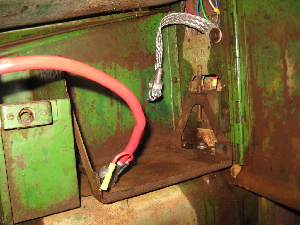

I have a 51 JDM that seems to have a weak ground. The battery is good, but when I try to crank it, it seems to drag. It is a 6volt positive ground system. The positive ground cable is one of those braided strap types. What gauge cable do you guys use for ground cables? Do any other M owners connect the ground anywhere else besides the instrument panel pedestal? I am looking for a better ground connection, if there is one.
Thanks,
Gary

I agree with FBH44. I've never understood other than to save money why JD engineers routed a battery ground cable to the battery box!!. Over time the batt box becomes rusty from sulfuric acid and every place that batt. box attaches will loose some amperage conductivity.

Not at all familiar with JD, but on a different color tractor I got tired of the slow starter, so I re-ran the ground wire from the battery directly over to the starter mounting bolt. Made a HUGE difference, the old starter really spins now. The prlblem was the return current was trying to go through several rusty aras, flanges, other bolts., etc. Now it's not.

Clean your grond up real good with a wore wheel and then reattach your strap. They never did turn over real good with that 6 volt battery.

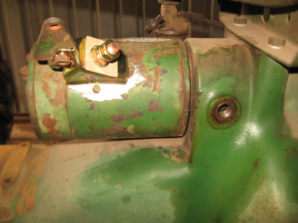

Have used the braided, positive ground strap for our 51M and all three 51 MTs.
Photobucket
Even with a new, 6 volt battery the starter would barely turn over on "Sam" our 51MT.
Photobucket
Removed the starter and turned the worn, copper switch terminal stud 180o to make better contact with the switch.
Photobucket
Also installed a new switch.
You might check to make sure there is a good connection with the switch and the copper switch terminal stud.
Last resort would be to remove and test the starter.
Hope this helps.
