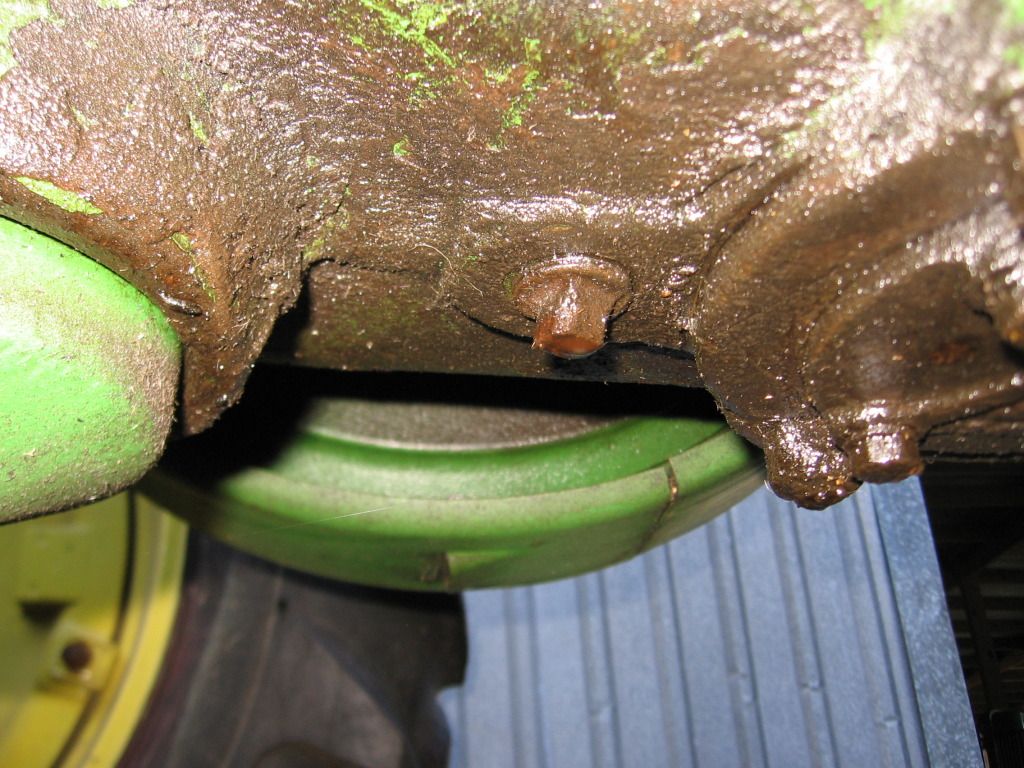

Best way to check for water in the oil is to remove the crankcase drain plug.

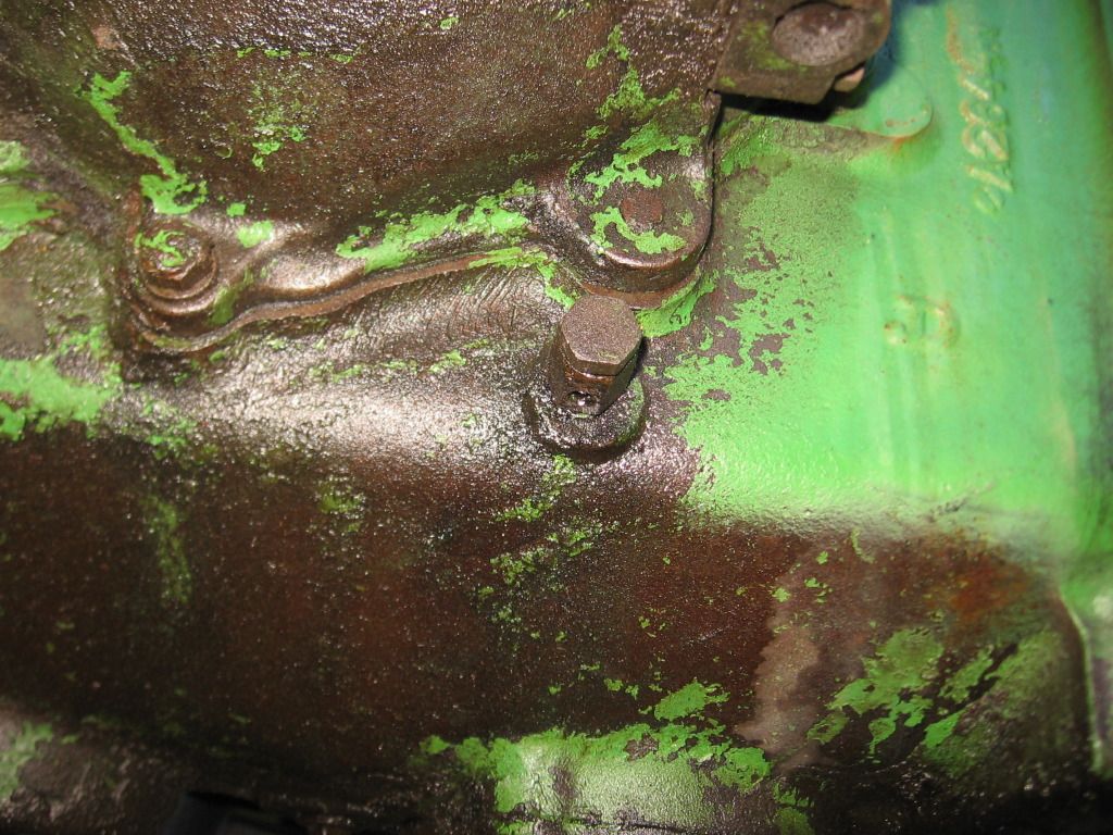

The engine oil is checked at the oil level test cock on the right side of the tractor under the pulley.
Photobucket
Open and fill until it drips.

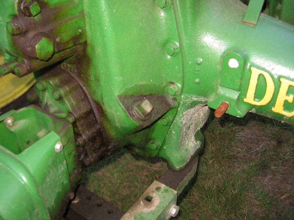

The transmission oil is checked at the fill plug.
Photobucket
Fill to the bottom of the threads.
