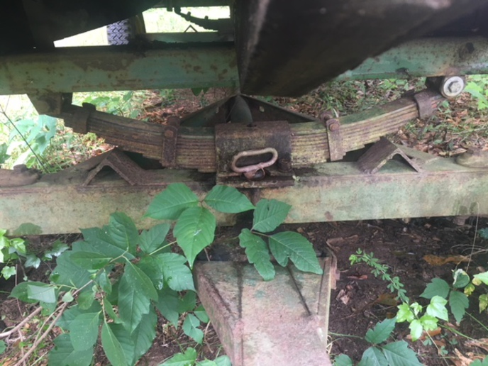

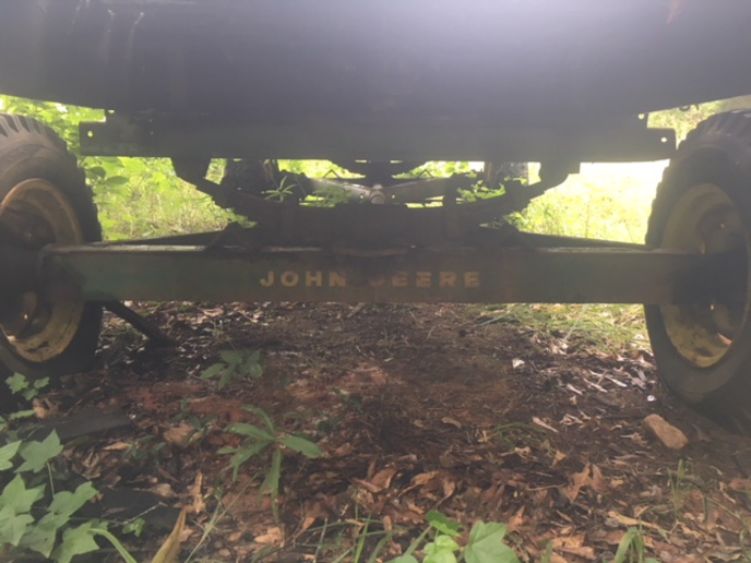

I have this older 963 JD running gear that was originally set up to haul peach crates and has the leaf springs on the axles. What (if anything) would I need to do to convert this to a hay wagon? Can I build the new deck directly to the existing brackets on the springs?I know new tires are in order as well as complete maintenance. I will probably paint it up while I am in the process.
Second question: Are there any plans out there available for building the wood deck and back stop? Not many people around this part of SC square bale directly to the wagon, rather they bale on the ground and pick up later. I have a shute extension for my baler.
I sincerely appreciate any help!
Thanks!
Ed
My poor itching hands, is that poison ivy between the tongue and the front bolster? I've rebuilt many running gears including JD 952, 953, and 963 but none with springs under the bolsters. I have had my hands on a 963 with springs but didn't buy it as it was too rusty for me. Seems to me that you can just replace what you have with 2 new main beams between the standards on the bolsters and install floor joists perpendicular to the beams. Leave the springs just as they are, supporting the bolsters. No need to remove them.
how many times has that one been turned over with the bed riding on a spring set-up like that
Yank the bolsters and ditch the springs. Reattach the bolster, and put a set of standards on them. Use a 3x8 oak set of beams,

Used to be common on hay wagons with springs. A lot were built on an old car frame with the springs left in. Only problem id you need more clearance between bed and tire to allow spring to flatten under load so bed does not hit tire. Only other thingis when empth and you walk on bed the bed will bounce a bit with each step, have to walk like you were on a boat walking. As strong as those springs are dought you will even feel them under you. And if you have uneven ground they will keep bed from flexing-bending under load going thru waterways. Just use a good pine 2x10" for stringers, 2x4" cross pieces bolted on with1/8" x 1.5 in angle iron and just pine boards for floor with 2x4 along edge but fasten all 4 corners down to spring bolsters. That will haul all the load that gear is rated for and that is a 5 ton gear and that rating includes the gear and bed plus load. And for uprights on back just take some strap steel and bend it in a loop and fastine to back of sills and just drop a 2x4 in, always made the loop about a quarter inch less than the 4" directin on the upright and notch the bottom that much so they do not drop down. And they were always at right angle to bed, never a tilt back. Bought first baler in about 1955 and used all kind of wagon gears from wood wheel with auto axles under to completely home made up to 953 JD. Not uncommon to put a 150 bale on a gear made from a set of car front axles. And if that small bounce bothers you just stick a block of wood in there to keep springs from working.

Joe W, I wondered if anyone would comment on the poison ivy when I took the picture! The gear has not been rolled, it is just "old" looking due to being stored outside for several years. It trails straight as an arrow at hwy speeds (empty) so I think I have a good starting point to rebuild this one. On the question of how to build the deck there seems to be a number of suggestions so I suppose it is whatever was common in the specific area. Is 3X8 large enough for beams or should I go 4X8 or thicker? What about length, is 16/0 about standard or longer? How about width? and how much deck should hang over front and back of gear?
