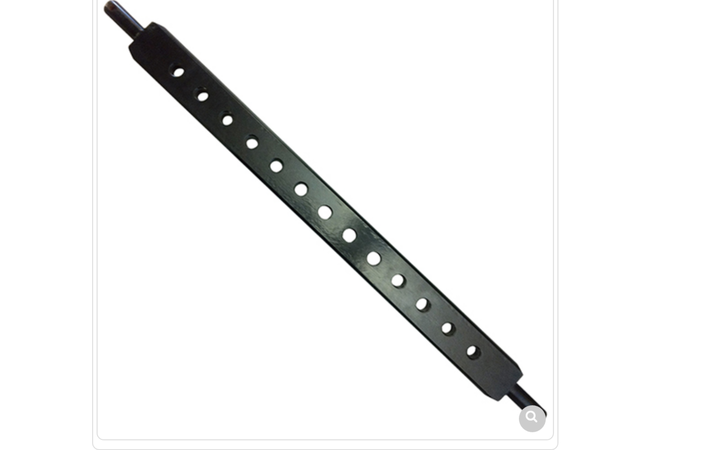

Would the 3 point hitch drawbar they sell at farm stores be strong enough for the hitch on a four bottom plow?

Make sure its not made in India or you'll have a bow on your hands.

Those store bought ones made these days bend easy.

3-point drawbars like the one you pictured also come as the heavier category II version.

Yes the one I want is category 2 . They come in two widths cat 1 width with 2 pins and cat 2 with 2 pins . I just bought a category 2 pin with cat 1 width for my mower

The maker of some implements around here uses solid round stock diameter of the category you need and then welds it in a piece of angle iron to mount it to the implement. Could probably do that cheaper then the draw bar with holes all through it.

I was thinking about that for a hitch on my mower . But I was going to use a piece of heavy pipe that would fit in the claws then cut a circle out of plate for the hitch pins and weld that to the pipe but then one of the claws was broken so I ended up using a drawbar instead

I have a farmer modified plow that used one for the hook up point. It's a 2 bottom rollover. I have not had any issues with it, category 1. It pulls hard in the ground here, will stop the 3010.

It might be, if its a cat. 2, but, that puts all the pressure on the 3pt arms and support brackets. The draw bar is hooked toward the center of the tractor giving your rear wheels more down pressure less slip. I think, could be wrong, just my thinking. gobble

Itís a semi mount plow

You need the factory designed unit, not some homemade job. Probably used ones avaible from parts yards. What make? Been a few years but yard I know had several plows being parted out. At that time mostly Deere 145.

John deere f145
