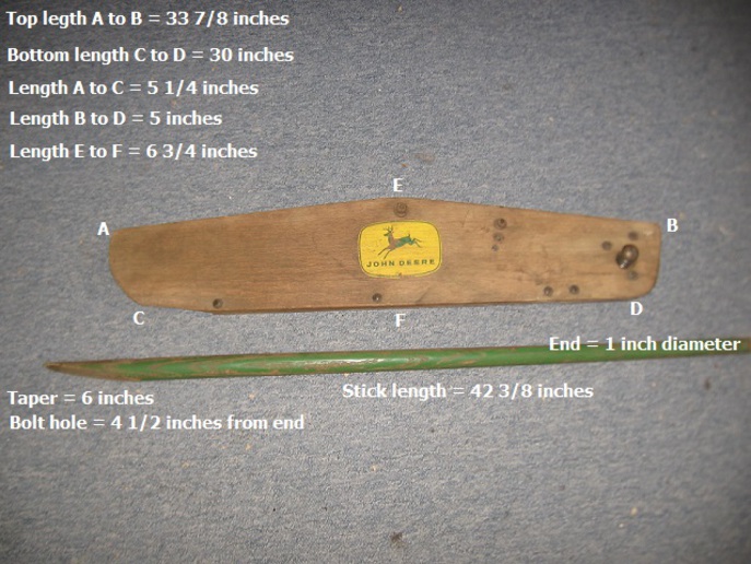

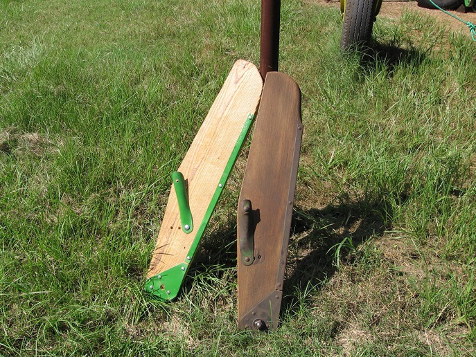

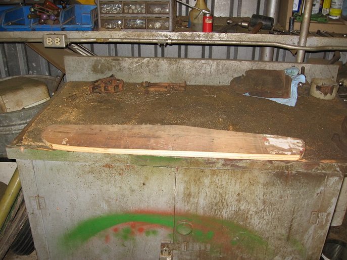

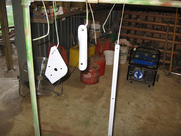

You might consider making your own wooden board.
Take a look at the photos below.
a249425.jpg" width="650"
a249426.jpg" width="650"
a249427.jpg" width="650"
a249428.jpg" width="650"
The photo below shows the grassboard measurements.
a249429.jpg" width="650"
Hope this helps.

yep, I replaced the wood on mine. Used a broom handle for the stick. Ive used it for around 35yrs.

I also bought one online some place but I cannot find the link anymore. It was a nice wooden one a guy make and sold. I bought it first and then made one using that one I bought as a pattern. Since then I have found the links I posted previously. I still have the one I bought and the one I made using oak for the board and a broken ash pitch fork handle for the rod.
You can buy the solid metal ones off ebay and other places they are pretty much a universal fit.The wooden boards for a show piece are fine but to use get an all metal one
if you want it to hold up as the wooden boards will break out lots of times backing up in heavy hay while clearing the blade.
