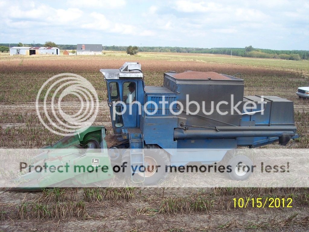

I have been back and forth between beans and sorghum for about two weeks now and snapping a couple of pictures when I can.I took the video camera with me the other day to try my luck at making a video to post but it turned out to be a day not made for making videos!I will try again soon.Also more pics to come soon.

Whats the difference between a 443 JD head and that 454 other than the high tin?

The 454 cuts off the whole plant right at the ground and feeds it into the combine. There used to be a few around here in NWIA cutting soybeans. One neighbor still uses a 4 row wide 454. Jim

A 443 is a corn head isnt it?If it is there is a LOT of difference in the two.The 454 uses two wavy belts to hold the crop while a rotating star shaped knife cuts it against a stationary knife.

Haley, great to see another pic of your old girl, interesting to see a JD head on it too... i looked for a grain header for my Claas 106 for the last couple of years, this year i made a massey fit... 2381 flex head (22ft), surprisingly easy... like you say, jackshaft was the hardest part, and that wasn"t exactly hard.

I've never seen sorghum but by the looks of what's in the tank I'd say you're doing a good job of cleaning it up. Thanks for the pics. Jim

Some years ago, at the end of corn harvest, a neighbor asked if I would combine his few acres of buckwheat, and sorghum! I had never done either. And didn't want to get my grain head back out from storage. But I did. I didn't do a very good job. The first bin full of buckwheat was dirty, but I got the second one cleaned up. I don't recall the sorghum in the bin, but recall that it threshed hard, unlike the buckwheat, which appeared to be shelled off about when it got into the head! The miserable old neighbor made sure I knew his old combine could do a better job! Looks like you're doing a beautiful job. Those row crop heads used to be very popular here for red kidney beans. Now it's all soybeans.

If you really want to see what your combine is made of then drive off in some of this thinking you are just going to mow it down like wheat and you will get a rude awakening!This time of year for us the grain has barely dried down but the stalk is still very much alive and growing new chutes for another head,At this stage it is some of the wettest,greenest,stickiest stuff you will ever run through a combine.I've had the cyl stopped up in sorghum than any other crop I cut.You honestly wouldnt believe the amount of green that we are sending through the machine when it is in this stage,Wierd thing is that after a frost it combines like a totally different crop.

thanks for posting I have never seen this crop what is it mainly used for? great pics looks like the machine is doing a great job too thanks to a good operator setup I am sure cnt

Do you have to do much to make the JD heads work on the Ford??

Very little had to be done.The jackshaft to drive it takes the most time.i will try to take some pics in the next few days of the shaft and feederhouse adapter.
