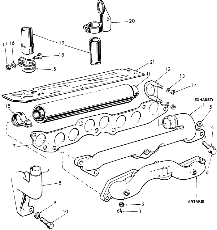

I bought a vertical exhaust kit for my 900 and it came with an extra clamp and a braket. Can anyone tell me were the bracket is suppose to bolt to. I think its from tisco.

Austin, I have a vertical exhaust on my 960 and on my Jubilee.
The 960 has the muffler moved out from under the hood and
inserted into the vertical pipe.
The Jube has a one piece bent pipe that attaches to the muffler
in it's original position then curves out from under the hood to go up.
Both have a clamp and bracket that attaches where the pipe would
hook to the muffler in the original setup.
That bracket is attached back under the hood to the gas tank
mount and helps support the weight of the muffler and pipe.
Is that the bracket you're talking about?
If so, no need to put holes in your hood.
Can you post a picture of it? I can get pics of mine if needed.

Sounds like one of those after market jobbys. You drill a hole towards the bottom of the hood and attach one end of the brace to the hood and the other end to the clamp on the exhaust pipe

For something more original you could go to New Holland (or Messick's) for part# 86534432 which is a steel elbow that has a flange welded to it that bolts onto the cylinder head. This then connects to the muffler outlet and clears the hood and provides the vertical direction. Then all you need is the vertical pipe, clamps, and rain cap. (The above part# was provided by showcrop in an earlier post about a similar subject.) This part costs about $65-$67 so be prepared. I don't think this site sells it but you should check.
In my case I needed to use a long bolt in the bottom hole and some washers behind the flange to get it to be exactly vertical. -Will

I think the elbow you are referring to only works on the 172 engine built after 1958 for the 8 and 901 series tractor with the bigger 1 5/8" exhaust pipe. I guess I am not aware of any 1 1/2" vertical exhaust built like the original

One question- The newer replacement manifolds accept either the larger or smaller elbows for the muffler inlet side. If that is true of all the manifolds then would it not be possible to use the larger cast elbow on the muffler inlet, the larger pipe muffler (both of which are readily available) and then the rest of the arrangement for the x01 I described above?
Probably replacing too many parts but might work unless there is something else about the x00 series I am forgetting about. -Will

I think u are rite this is only for the 01 series.

Here's a parts diagram of the vert. exhaust kit showing the cast elbow(#8)...I pulled this off of the Partspring website under the 801 series, but I would think your 900 has the same upsized muffler outlet.
