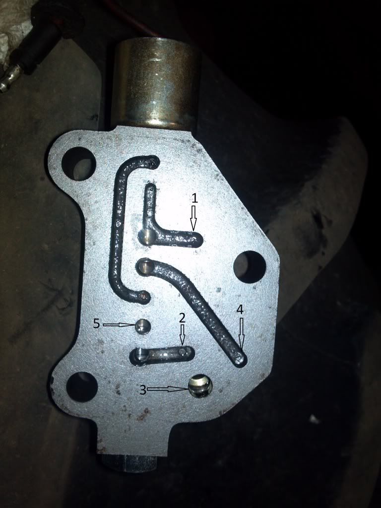

I searched till I'm blue in the face but can't find the answer or is the answer to get a different manual, I'm using an IT manual.
The problem started 3 yrs ago when it wouldn't pull anymore in direct or DP, took pressure readings then and was getting 90/95 psi. Took the DP out of the loop (dead head to the guage) and got 150/155 the very low side of acceptable with DP in the loop. At that time I replaced everything in the DP (seals and clutch packs) and new after market hyd pump. this did not change pressure readings but I could now use the tractor and it didn't seem to slip. I removed the rearend cover to get to the pressure regulator and shimmed the pressure spring. I also rebuilt the pto clutch pack while I was in there. All this had little to no affect on pressure readings still at min. or slightly below. Next I changed the hyd valve with solenoid new from NH. this did not change the pressure at all, it did make the delay longer between shifts so I put the old one back on. I gave up trying to get the pressures up and got by until now, basicly same thing 3 yrs later.
This time I shimmed the regulator more and got the pressure above 190 when dead headed to the guage but loses 65 psi when DP is in the loop. I reassembled DP on the work bench and put air pressure to the clutch pack ports one pack leaks nothing and the other leaks very little, I'm thinking it's flowing too much oil to the lube ports causing the pressure drop. I'm open to suggestions, I'm considering making a restrictor to put in the lube port hole.

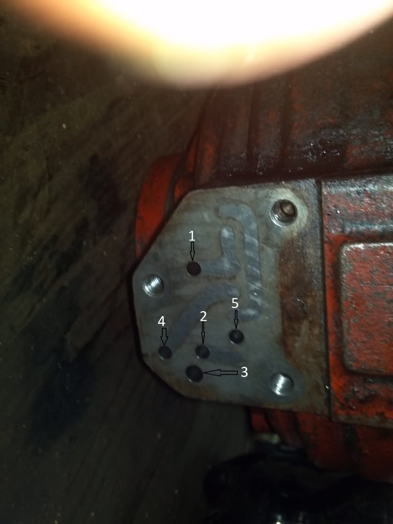

If the photo links work I'll try to explain
1 & 2 is a direct passage into an open cavity, these two have me a little puzzled. I believe this is where it's flowing too much and reducing my pressure. these passages do not flow oil from the lube circuit coming from the oil cooler it looks to me like the oil comes from the spool valve which is taking from the high pressure line.
3 is where lube oil flows from oil cooler, looks like it flows directly through the valve into the DP and is in no way controlled by the valve.
4 this flows oil to the clutch pack inside the carrier through the ringed groove. When I apply air pressure to this port and hold it, it does leak down in about 2 sec.
5 this flows oil to the larger piston and when I apply air to this and hold it does not leak off at all.

Have you checked the screen at the inlet to the DP control valve where supply oil enters?
1 & 2 as pictured are likely the exhaust ports for each clutch pack. When the control valve shifts from high to low or vice versa... the trapped oil needs an escape route. Quickly. Those would no doubt dump into the mechanics of the clutch unrestricted.
I would be somewhat concerned about the leakoff you have on the direct clutch. I don't know how you're accurately testing that on a bench tho... I think I'd do a thorough visual of the sealing ring surfaces again. Make sure the rings turn freely in their lands and that the lands aren't cut/scored badly from lack of lube in the past. Likewise make sure there's no groove in the main housing where the sealing rings ride...
Beyond that it's basically just the rubber seals on the clutch pistons. There's a touch to installing them so that they don't pinch or roll when you install the pistons... Likewise there's a knack to getting the direct clutch and carrier in place without busting the sealing rings. I know I busted one or two the first time I tried... and was lucky I had extra's.
I'd also make a point of installing the test gauge in the manifold port on the pump... but I can't see it making any difference where exactly it is placed unless you've got obstructions in fittings that are causing the pressure loss.
You just have to keep following it out logically. If it's not making pressure it's either got a leak or the pump is not supplying enough oil.

Those sealing rings on the back of the direct housing of mine were originally cast iron running in a steel sleeve. When I rebuilt it about 10 years ago the new rings were plastic. Two years ago I had it apart again to do some work on the tranny and I noticed some pretty good grooves where those plastic rings ride because being plastic they pick up particles which can be abrasive. This is something worth taking a good look at.

I didn't find the culprit yet, the sealing ring surface does have some grooves, if I decide to do something about it what are my options? the reason I say if is because the pressure on under drive is low too so I don't think that is the real problem.
I bolted the valve to the DP case and applied air to the input port, the under drive piston applied and it leaked air from port 1 & 2 significantly more from port 2. I then applied 12v to the solenoid and the direct drive pack applied and it leaked air from ports 1 & 2 again but this time mostly from port 1.
I think I failed to mention about a yr ago the solenoid failed on the valve so I was forced to use the valve I bought for the first rebuild 2 yrs prior and didn't use it because of the longer delay when switching. I called the dealer to be sure I got the right valve for this tractor and they assured me it is.
