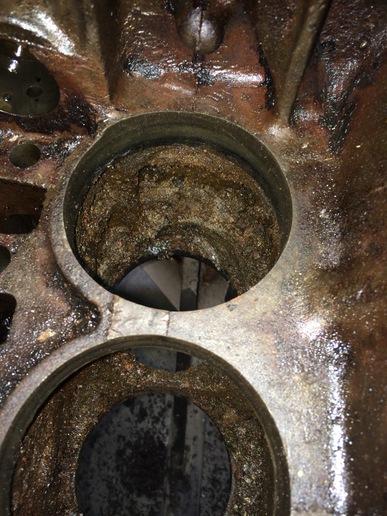

I've had this TO-30 for several years and use it regularly for light duty tasks on a farm. When I purchased it there was an issue with coolant use and when first started after sitting it would run on three cylinders for a short while and exhaust some white fog. I just kept the coolant topped off and since it's not used hard just lived with the problem. Recently the coolant issue has gotten worse and the engine suddenly developed a leaky rear main seal.
So it's time to address the issues. I pulled the head today expecting to find a cracked block but hoping that a head gasket might cure the problem. I found a broken valve spring on #1 exhaust. I found coolant in #3 cylinder but no obvious route from the coolant jacket to the cylinder. I see no sign of any cracking associated with the block. The head gasket shows deterioration between #2 and #3 cylinders, but no leakage between them or from the coolant jacket to the area.
I'm going to keep going deeper. To replace the rear main seal will require near full disassembly. Hard to say what I'll run into associated with main and rod bearings/crankshaft condition. I'd like to return the machine to good operating condition with the minimum of money spent.
I'd solicit any suggestions from members here about proceeding. My current plan is to remove the oil pan and pop the pistons out. The cylinders exhibit minor wear near the top, I've seen worse and if I don't find any real problems I'll hone and re-ring.
The rear main seal worries me - the engine has been decently oil tight, then suddenly there was a small but steady stream of engine oil exiting the bell housing - not a drip, but a stream. It seems to be all or nothing, sometimes it would start and run and no leak, the next time it would pump out the engine lubricant in a couple of hours of running. Dunno - All I know to do is look at the area, evaluate the condition of the crank and bearings, and replace what's necessary.
some pictures for you

The head gasket was obviously leaking, that explains the coolant in the oil and #3.
The rear seal streaming oil will be real difficult to properly repair without pulling the engine. Likely
there will be some crank and bearing damage from the contaminated oil, or just from wear.
My suggestion would be to go ahead and pull the engine, get it out where you can see what's there. It's
really not that much more work considering the option of laying under it with oil dripping in your face.
Something else, if you are not aware, the cylinder liners just sit in the block with oring seals at the
bottom. If any move up, the seal will be broken and the liner will need to come out to be resealed. Not an
easy job when sediment from the coolant gets under the liner!
Those seals really need to be replaced anyway, at their age they have to be deteriorated.
I've done inframe overhauls before, but usually when the engine was in relatively good condition other than
smoking. Even then it's a big shortcut than can easily come back to haunt you.

I?m with Steve on this. Pull the engine, get an inexpensive engine stand to park the engine on to work. A sleeve puller is easy to fashion out of threaded rod and angle iron. Look for small cracks between the lower webs, like the one you have on top. A machine shop can put bolts into the block to pull the cracks together, this is called pinning. I have had three blocks done this way. In the end you will have a strong and fresh engine.
yes - with the rear main seal issue there's really no option but pulling the engine -
I worked this evening getting the block de-accessoried and the front suspension out of the way - tomorrow I'll have to set some vehicles outside (it's winter here again, cold and snow) and dig the engine stand out of the loft -
it's going to be real easy to get more money wrapped up in this than the machine is worth - there's no place to stop...

speaking of big deals, I think that is where this engine is headed... it is out and I need to make a run to the hardware tomorrow to get some long enough bolts to get it mounted to the engine stand - then get the internal components out and see what I'm up against - it looks like it's been TISCOed at some point, the bore is 3 3/8", but how the crank was dealt with remains to be determined - I'm concerned that every component will need rebuilt/refurbished/replaced - the clutch, it's worn some, how can I not replace the disc? and he pilot and throwout bearing? even tho they feel fine....$$$
We are having fun now -
I did find the rear main seal issue - spring that holds it tight around the crank was broken -
I am happy with what I've found, generally - the bearings look like new - - I'm thinking about things, but I'm inclined to reuse them - they are standard bearings - I am up against lack of tools now, I don't have a set of micrometers that can check the crank and rod journals - I'll have to either borrow or haul the crank somewhere -
I don't see any sign of the block cracking at the lower end of the web - rod bearings look just as good as the mains, I haven't examined the pistons/wrist pins closely yet, but it seem likely that I can buy a set of rings and get back in business -
Someone mentioned pulling the sleeves and resealing - the sleeves are sealed to the block with o-rings? o-rings of the sort that are available at a hardware store? I'm not opposed to doing that, but I'm not looking for trouble either....
